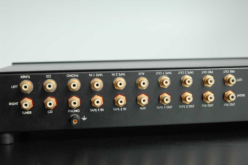

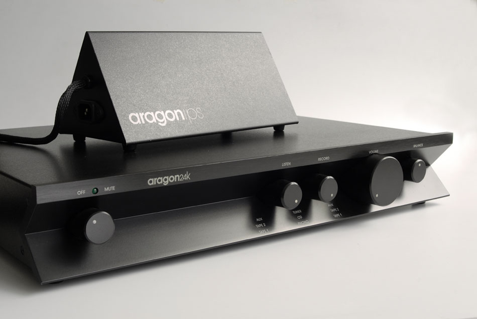

[#4709] ETSC & ETRC & ESAC Members (44)
Just found the specification of the Aragon 24K that it installed with a quite precised phono stage for mm and mc with adjustable loading/gain :-
Phono Section
Prior to making adjustments for the moving coil section, please be certain the pre-amplifier { NOT plugged Into an A. C. outlet. If you are using a moving magnet or high output moving coil, It Is set up properly at the factory, and you will not need to alter the Inside switches. Please continue to the next section - Power Supply. If you are using a low output moving coil, please read the following:
Soldered onto the circuit board are 3 switches for moving call adjustments. To access them be sure the pre-amp Is unplugged from the A.C. outlet, remove the screws from the top cover, and you will notice 2 switches with 9 positions on the right side of the circuit board. Closer to the center Is a single 2 position switch. For moving call gain, the 2 position switch should have both tabs depressed towards the left (C1 & C3).
The 2 switches on the right adjust loading for the two channels. therefore the adjustments should be identical on both. Each switch, from 1 to 8 will present the following load:
1 - 10 ohms
2 - 25 ohms
3 - 47 ohms
4 - 100 ohms
5 - 249 ohms
6 - 475 ohms
7 - 825 ohms
8 - 1000 ohms
Check with the moving coil manufacturer as to what load is recommended. You will notice that the volume will decrease as you lower the load. i.e. 10 ohms will have less gain than 47,000 ohms.
By combining switches you can create different loads. To know what load you are creating, multiply the two values, then add the two values,
then divide the added value Into the multiplied value to determine the resistance.
Example: switch 4 = 100 ohms
switch 6=475 ohms
Multiply 47,500 / Add 575 = 82.6 ohms
Therefore when switches 4 and 6 are depressed the load is 83 ohms.
