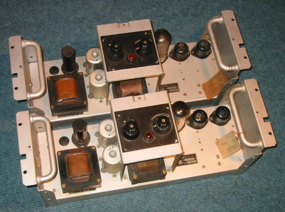

請問Klangfilm FE40是否可用FE86膽? 那地方有得買? 幾錢對。此機有壞,那地方可修理?

They are different sockets. Don't suggest to change it. Which model do you have?

[#3] klangfilm
Thank, 41450686 hing! 6SELA 2798
此網站是否說明可代用EF86膽,或有甚麼代用膽?

[#4] klangfilm
Not really, electrically is the same but they uses different socket. EF40 is rimlock 8pin, EF86 is 9pin. Normally, EF40 is better than EF86 so no reason to change. For me, I just want to change EF86 to EF40. EF40 is very nice.
I think you need to modify the output transformer to 8ohm. Mostly you need to change the power capacitor in this circuit. Be careful the capacitor with the plastic cap, it has high voltage on the surface. It uses two EL34s outputs 100W. It makes the EL34 easy to die.

[#7] klangfilm
EF40 is electrically similar to EF86 but with different pin out.
Plug EF86 in to replace EF40 will result in permanent damage to your amp and maybe yourself as well!
