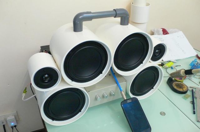

[#1] 狂呼我空虛!!
M-Club效應,整左件大殺傷力武器,好爆到呢!!!!

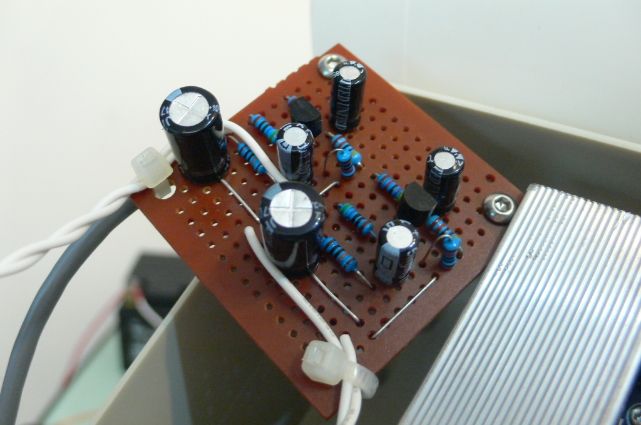

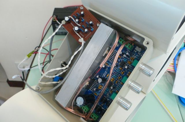

[#4] 狂呼我空虛!!
個輸入靈敏度唔夠高,整粒BC548佢補一補!

[#6] 狂呼我空虛!!
Why don't use opamp for increase the gain ?

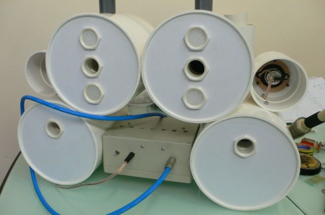

[#7] 狂呼我空虛!!
如果低音PVC膠管道改為6-8呎長,低頻量更無敵.^^

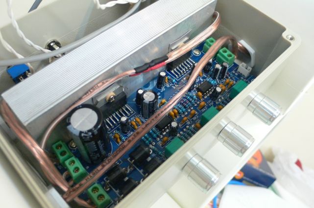

[#8] 狂呼我空虛!!
Lm3886?
patkwok
116.xxx.xxx.130
2014-05-04 20:27
[#9] 狂呼我空虛!!
"Why don't use opamp for increase the gain ?"
是但啦!最緊要平,9蚊零件攪掂,又唔係要低失真。
"Lm3886?"
唔係,係TDA 7377淘寶貨,
http://item.taobao.com/item.htm?spm=a230r.1.14.25.YjxMgs&id=22140984587
"如果低音PVC膠管道改為6-8呎長,低頻量更無敵."
咁咪要搵貨Van車去深水灣? ^-^

[#12] 狂呼我空虛!!
Tom兄:
個舊唔係P記12V電,係我部CBR1000電單車,舊Yuasa 12V 9.1A電池,估計由頭爆到尾,頂到2個零鐘,帶兩舊電去玩,快慢歌兩溝,6個鐘應該冇問題。我唔識點樣擺條片上網,如果唔係可以比大家睇下,佢工作時既威力。
