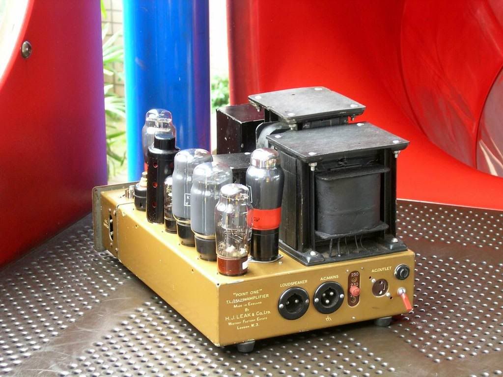

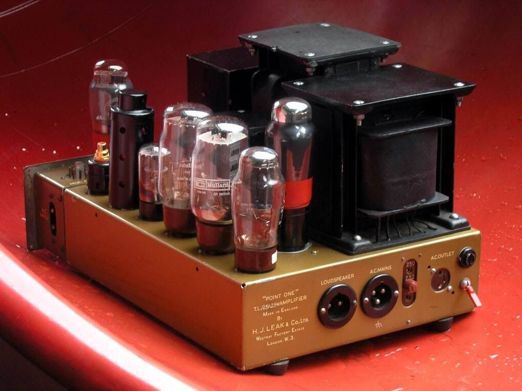

After listening to 12.1 + 3/5A, I am afraid I will step onto a road of no return.
Please give me a chance
Leak TL/25A :-)

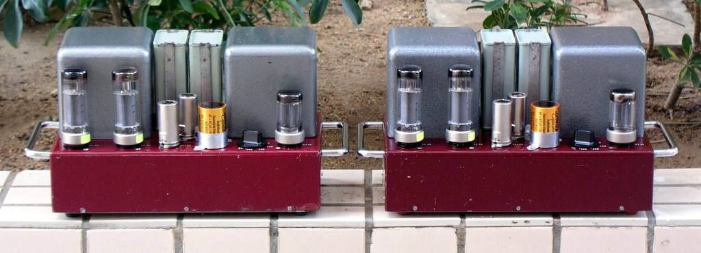

This pair of KT66 Williamson also has Partridge OPT.
http://cgi.ebay.com/ws/eBayISAPI.dll?ViewItem&item=360108948413

WHAT is it?

I like this kind of handle :-)

This tank must be a big one :-)

In 1958/59, a copy of the World Famous DTN Williamson amplifier was produced with Partridge Output transformer, 5V4G, 6SN7, 12AU7, and a pair of KT66 output tubes, producing 10 watts of power at less than 0.3% distortion. Audiophiles the world over have since been searching for this elusive machine, The "Mighty" Electrohome PA-100 MK-1. MK-1 is a gold coloured monobloc, the PA-100 is white/creme coloured with black transformers, and it's been rumoured they produced a chrome version.
