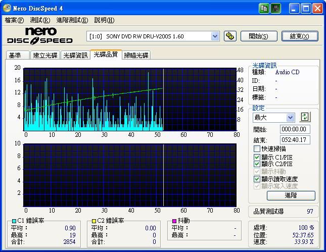

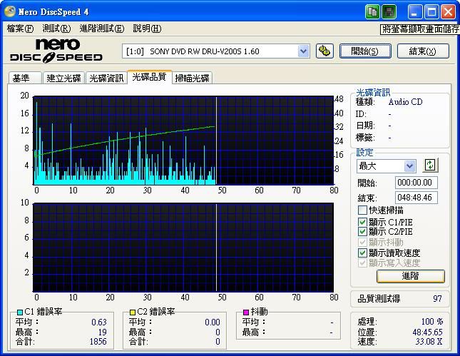

Vili Hing, I tested on 6 difference TIS disc tonight, firstly, you and Harmonic Hall doing a good job on disc quality, the Heart Breaker getting 3rd lowest Avg C1 out of 50 disc tested, No.1 is Ting Ting HQCD by Memory Tech Japan, C1 Avg 0.23, 2nd is previously posted Warren Mok 24K Gold by Toshiba, Avg C1 of 0.59, and Heart Breaker just Aluminium Disc by Harmonic Hall, a disc been played for 13 years, without 24K gold and HQCD technology, but really respectable figure of 0.63 Avg C1!!
Unplug Golden Gate also getting very low Avg C1 of 0.9.
http://i50.photobucket.com/albums/f308/herculescheung/CD-CD-R%20C1C2%20Test%20result/TISUnplugGoldenGate-HarmonicHallAlDHMDisc.jpg
It's Made in Hong Kong, sadly Harmonic Hall no longer in business.

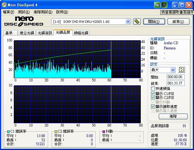

Hi Vili hing, I also own your Crystal Disc, I never purchase any Chinese TIS disc (I only got Harmonic Hall and current 16s, and Crystal disc, 1x years apart)
If you have time, can you verify the crystal on your hand, even I don't think it's not your burning process problem, my Snow Rose Crystal is very high in C1 Avg figure, which is the same problem found in Hugo LPCD45, coloured CD-R disc manufactured by Plasmon.
