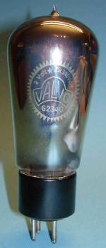

[#3712] tube+horn systems無膽不歡號角天地會
另外valvo G2340 , 1701 亦好正!
tubediyer
218.xxx.xxx.96

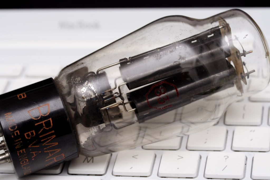

Some 83 are not that dry~
taimonsing
218.xxx.xxx.217
2008-10-02 09:56
[#3718] tube+horn systems無膽不歡號角天地會
83 also have mesh plate~~ no, is mesh getter
taimonsing
218.xxx.xxx.217
2008-10-02 09:57
[#3719] tube+horn systems無膽不歡號角天地會
taimonsing hing, the 83 i tried was RCA one. thanks for sharing the photos. perhaps Brimar is better. first time i see a mesh getter. look really nice!
