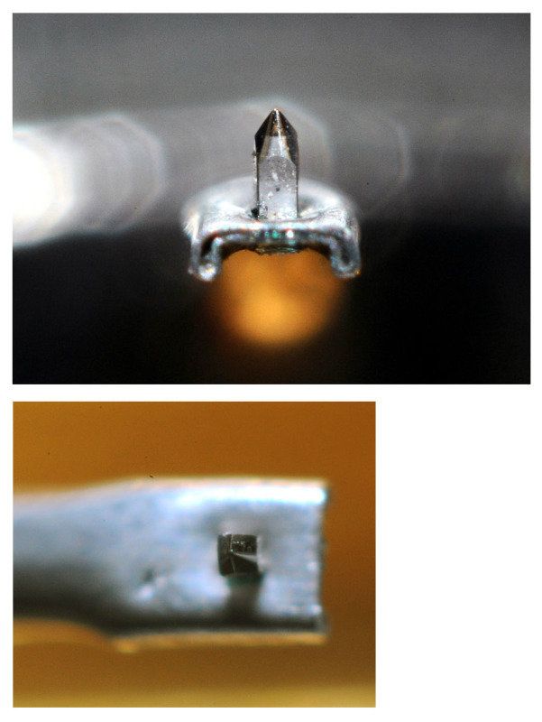

[#28] 研究J形,S形,直臂的特色
嘩!粒鑽石好大粒呀。幾多卡?^^
孟波
123.xxx.xxx.186
2012-06-20 22:35
[#29] 研究J形,S形,直臂的特色
Ssssh... Don't tell my wife, its for my girl friendssss....
The tonearm....
