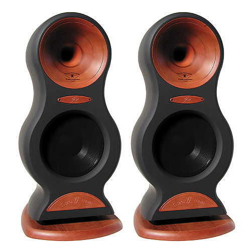

The 12" plastic waveguide has a very similar contour and dimension (but not material) to the horn on Zingali designed by Geddes.
Zingali flaship also uses B&C DE500-8
