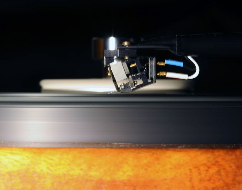

[#46] 研究J形,S形,直臂的特色
Ball Sir,
Good pic, just copy into my record, thanks!
Can you tell the condition of the following photo?
Photo-1
et2
124.xxx.xxx.19
2012-06-23 13:43

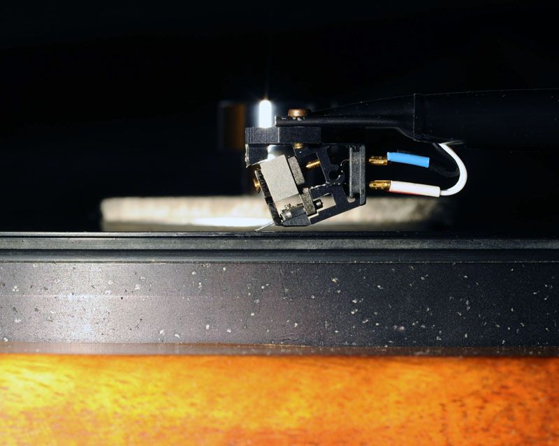

[#47] 研究J形,S形,直臂的特色
Photo-2
et2
124.xxx.xxx.19
2012-06-23 13:44

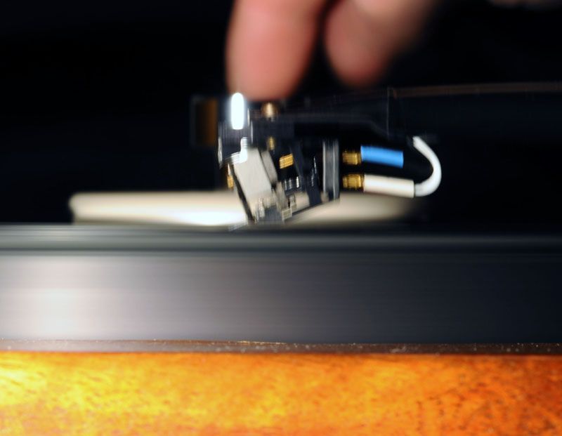

[#48] 研究J形,S形,直臂的特色
Photo-3
All by 1 sec.
et2
124.xxx.xxx.19
2012-06-23 13:45
[#49] 研究J形,S形,直臂的特色
et2兄:
係咪
第一張唱盤未起動。
第二張開始唱。
第三張唱到唱臂/唱頭組合既諧振頻率片段,見到支臂上下跳動?
最後修改時間: 2012-06-23 13:52:03
孟波
123.xxx.xxx.186
2012-06-23 13:49
[#50] 研究J形,S形,直臂的特色
Ball Sir,
You got 9 out of 10.
Actually the 3rd is by manual 諧振!!!
et2
124.xxx.xxx.19
2012-06-23 13:56
[#51] 研究J形,S形,直臂的特色
VRF is about 10Hz
HRF is about 6.5Hz
TT Vertical vibration is about 3-4 Hz (Guess).
Peak to peak > 2mm
The bass still very solid and the sound image also very stable.
最後修改時間: 2012-06-23 14:02:57
et2
124.xxx.xxx.19
2012-06-23 14:00
