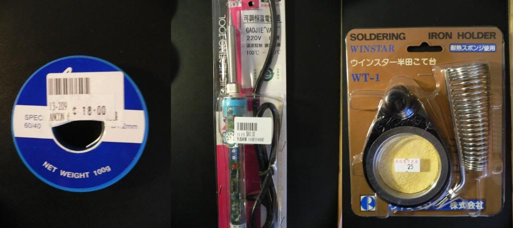

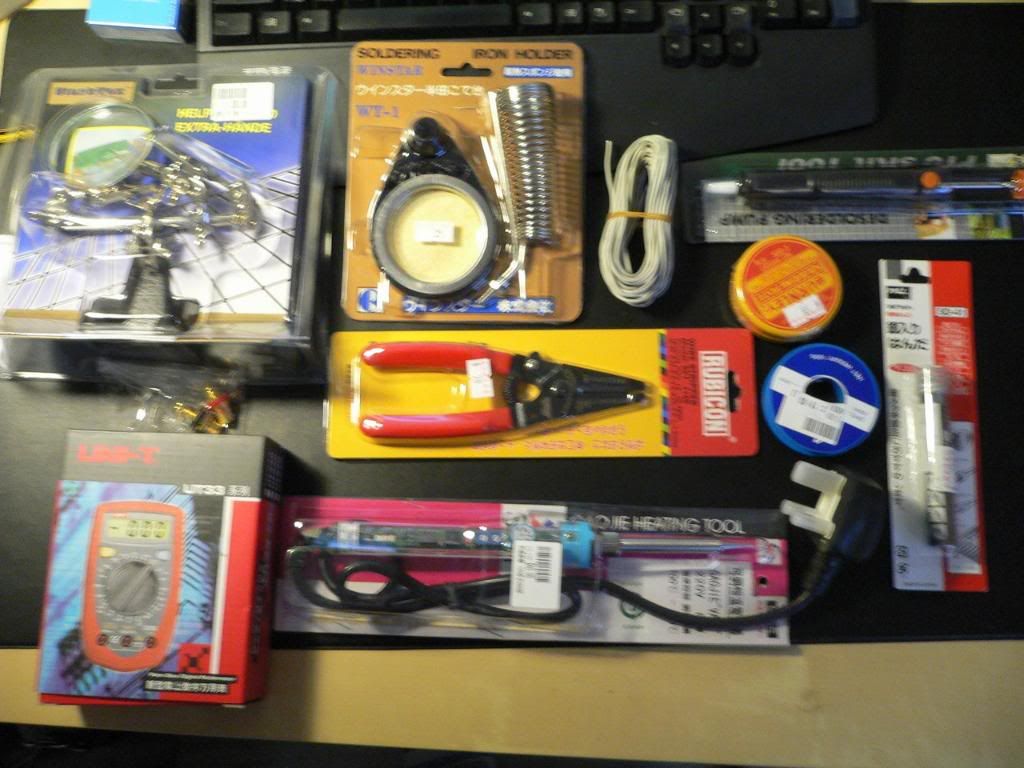

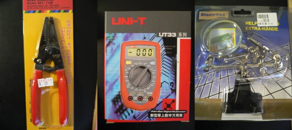

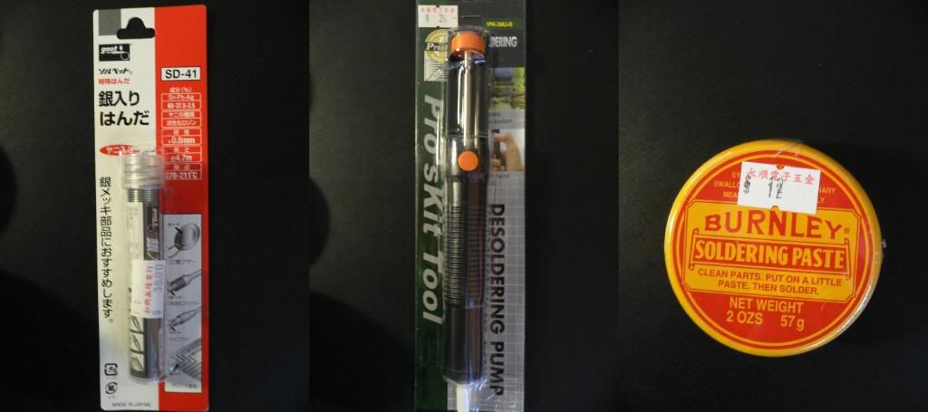

Just to share my newbie experience, partly for thanking estang3 hing, and partly for those even greener than me :) I followed his advice to buy something from SSP. I bought the things in the pics. Some are terrible - the soldering iron made in China quitted working after some rounds of practice, yet estang hing said I was unlucky since his is still working (the same model); the desoldering 'suck' (forgot the name) made in taiwan was also broken once out of the box (he did recommend me to buy Japan ones).

[#48] 焊訊號線

[#49] 焊訊號線
another one

[#50] 焊訊號線
more

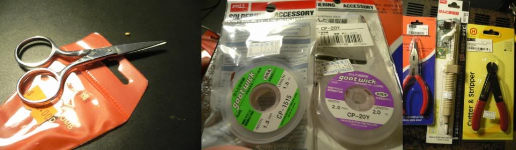

[#51] 焊訊號線
I later bought a Japanese soldering iron which can control temperature. But I forgot that I should bought an 'iron rod' with a better size. I just lived with it. Also I bought another Japan-made desoldering 'suck' - but I finally find it difficult to use. I further bought some desoldering 'copper tapes' (like tapes), which proved to be easier for me as a newbie to desolder things.

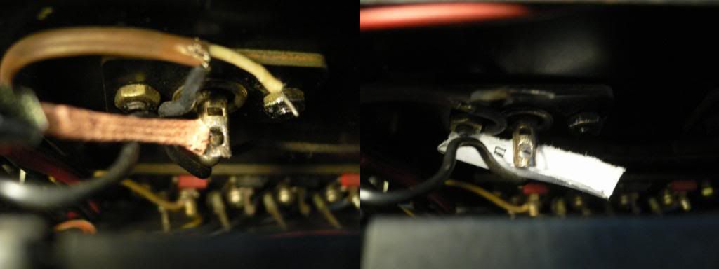

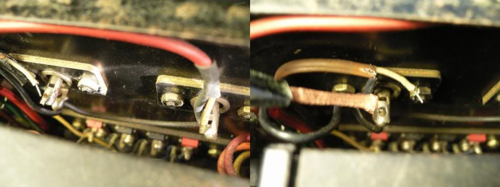

[#52] 焊訊號線
The problem of mine was that the wire connecting the left RCA was broken. Hope the pics showed clearly. The wire was so tightly packed inside the amp so I have to strip away some 'plastic' in order to enable the wire to move a bit more freely inside the amp (estang3's advice!).

[#53] 焊訊號線
Then I use that desoldering tape to place over the rca jacket and 'absorb' the extra tins. It was rather difficult since I didn't remove the RCA out (I guess estang3 may laugh when he see I do this without taking RCA - how foolish I was!). Anyway, may be due to beginner's luck I managed to 'absorb' all the sturdy, old tins around the RCA. Then I used siccsors to strip anyway extra tins left untinned. Then ... my camera went out of order !!! I didn't take pics of the repaired RCA, but I could say I did it! The amp is singing again, and thanks so much to estang3 hing.
