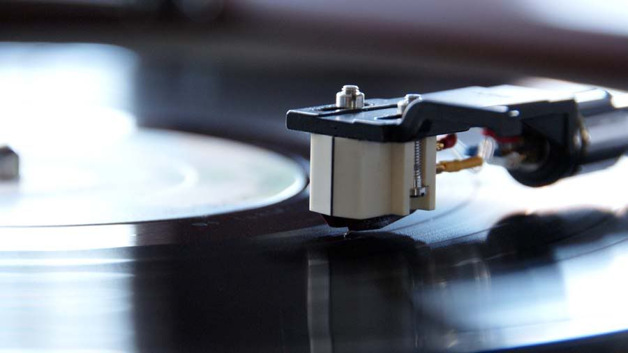

Ball Sir,
Look at the photo 1 & 2 check the difference of the cantilever.
Sorry for off topic!

et2兄:
第一張相唱盤是靜止的,唱針cantiliver的角度和照片2相比會較高。
相片2的VTA才是工作時的真實角度。
有冇估錯?

“相片2的VTA才是工作時的真實角度。”
Yes, exactly.
This kind of phenomena I explained to a member of R33 few years ago, due to the dragging force added on the tip so the dynamic VTA will be slightly difference with the static and the angle formed also depends on difference kinds of factors such as Tracking Force, Dynamic Compliance.
So you were right the fine tune must by listening.

et2兄:
係呀,我一向都覺得校VTA用聽好過用量角器度。
最後修改時間: 2012-06-25 22:24:22
