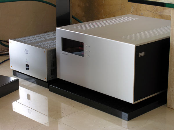

當 M10 遇上 710(係左邊喇叭後面)
citizen
219.xxx.xxx.192
2007-09-20 23:26
[#71] soulution 好友俱樂部
睇清楚D...
citizen
219.xxx.xxx.192
2007-09-20 23:27
