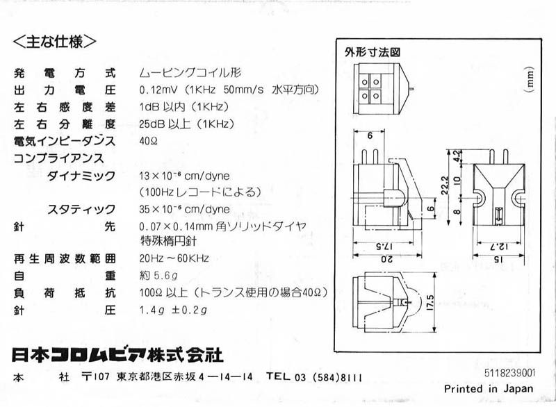

[#87] 研究J形,S形,直臂的特色
I guess the design of 103M was follow the design of 3 series but cheapest version, I didn’t play my 103M for more than 20 years, doesn’t know still work or not.
The stylus is special elliptical and just 0.07mm X 0.14mm
The finest from Denon now is
DL-S1 0.07 X 0.07mm
and from my memory the
DL1000A is 0.06X 0.06mm
Don't know any member of R33 got this one? I mean DL1000A.
Just check DL-305 is 0.05mm X 0.1mm
最後修改時間: 2012-06-30 14:25:10
