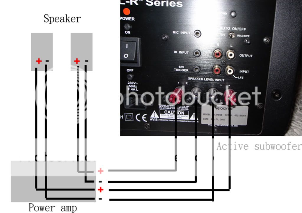

Ching,
i have a active speaker and like to connect to my 2 channel system..is it connect like the diagram. a power amp connect to both speaker and active sub... no problem right? actually i have a pre amp too... so i used to connect direct from preamp to the lfe input... which connection method can achieve better result?

[#86] Using subwoofer in a 2-channel system
Each REL subwoofer should come with a new set of Speakon Cable.
It is very very easy to DIY. I never use my REL Speakon cable as I DIY one using a 13 AWG electric cord. Then, I buy an after-market Speakon cable later.
Degnuf; Your velodyne should be hooked up to your amp. That means, your amp would have speaker cables to your main speakers, and also, subwoofer cables to your Velodyne.
You do not need fancy subwoofer cables. Some thick lamp cord (red / black) cables would do just fine..
Have fun.
Kenny
218.xxx.xxx.123
2009-03-14 18:44
[#87] Using subwoofer in a 2-channel system
thanks kenny,
so say my speaker cable is spade connector, then i use banana plug cable connect the amp with the subwoofer right?? also, for this method, does it mean the power of the subwoofer shut down automatically itself and the power amp will provide power for the sub...and do the crossover of the sub will disable also??

[#89] Using subwoofer in a 2-channel system
Degnuf; your subwoofer needs to be power up all the time. Because of impedance of the subwoofer is very high compared with the main speaker, so the subwoofer takes out very small current/power from the amp. The high-level connection should be treated as a signal path only.
Search1818; bass should be felt, but not heard, so it is extremely difficult to adjust volume each time.
