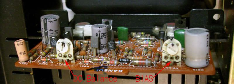

朋友號兄,BIAS係指Power管起無音樂訊號時,所流過嘅"靜態電流",Power管一般都有E腳電阻(Re),Power管有"靜態電流"流過,起Re上一定會有電壓降,度左電壓便可以計出現在的BIAS
e.g. Re=0.47Ω,Vre=14mV
BIAS (mA) =Vre (mV) / Re (Ω) = 14/0.47 = 30mA
一般Re起Power管附近,大多數打開機底可以見到。

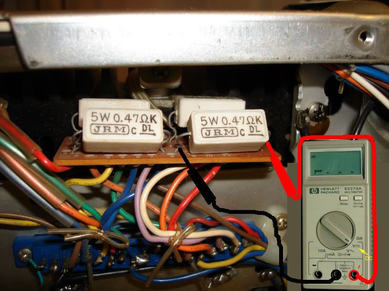

[#102] etsang3 修理好聲"山水"機一部
"Re"係四四方方白色嘅電阻,多數0.22Ω至0.47Ω(3W =10W)
,他錶選"DC電壓"檔,紅黑棒度電阻兩腳即可。
度之前最好用利器刮一刮電阻腳,除去氧化物,度得準確一些。

[#103] etsang3 修理好聲"山水"機一部
調較BIAS :
1.調較任何VR之前,應該在VR上或一記號,記住現在位置,有問題或調錯了可以"還原"
2.舊山水amp最好換左VR先至調較,因為舊山水ampVR大多數都氧化損害,一調較便會不穩定,BIAS VR 不穩定會導致燒Power管。
etsang3
203.xxx.xxx.131
2009-07-27 01:54

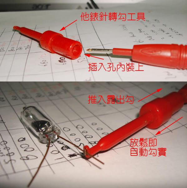

[#104] etsang3 修理好聲"山水"機一部
用他錶紅黑棒直接度Re會有D危險,一不小心short到V+或V-,珍貴嘅power管就會玩完!
我建議去買"試棒轉試勾"加到紅黑棒,勾住Re兩腳度, 唔怕手震。

[#107] etsang3 修理好聲"山水"機一部
朋友號 兄, as I know each power transistor should be BIAS 30mA (min) in order to prevent X-over distortion. I will measure all the 6 Re resisters. (0.47Ω) and find out the the smallest voltage one.
Then tune it up to 14mV (for 30mA BIAS). Then other 5 power transistors will be biased more that 30mA.
etsang3
218.xxx.xxx.160
2009-07-28 00:11

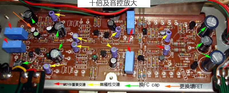

[#111] etsang3 修理好聲"山水"機一部
各位兄台,因為忙,過兩日先POST整機相比大家分享,今次"快"修,因為"工多藝熟",一開波就換哂電容(橙色電解,樹脂封底,全部打柴!!!),仲有一粒輸入FET被打到漏電內傷,自我製造"啪啪"噪音。
KinSukSuk 兄,你的AU9500先天足內力夠,我每粒管BIAS能調大到100mA也十分安全。你應該發覺它現在"通透又有勁",有甚麼聽後感請反饋分享,謝謝。

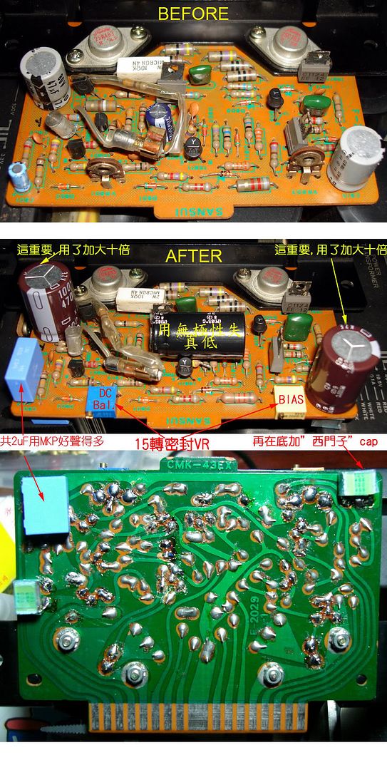

[#120] etsang3 修理山水AU-D9
The AU-D9 is back ! Take more care to fix this time.
(1) changed the circuit to better match to use wide bandwidth power transistor
(2) replace all old leakage driver (A968/C2238)
(3) replace leak ecap to MKP as much as possible
(4) Find out more cracked old soldering and fix them (terrible at the Preamp broad)
Here are the photos for sharing.
- Modified the circuit
etsang3
202.xxx.xxx.193
2009-08-12 14:35
