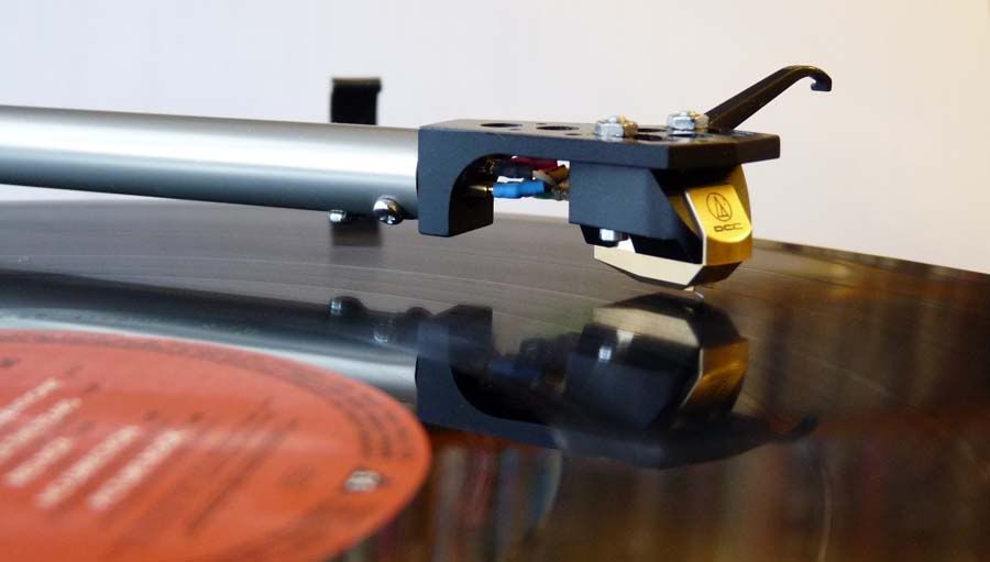

The 103 or103R needs a heavy arm to perform at its best; one with an effective mass of 20 grams is the minimal requirement. The Ittok is about 12 grams so it is not an ideal match though it still works adequately.
My 103R has been modified and housed in an aluminium body which lifts its performance to a higher level.
My AT OC9

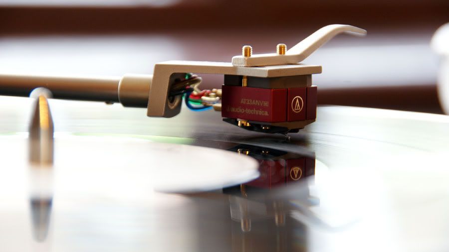

AT 33ANV
