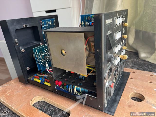

here are the photos of the mm and mc card I removed from the old Primare 928, the
mm card is close to the mc card so the view is not very clear
appreciate any advice
Thanks

Wow....... thanks for showing the pictures of your MM & MC cards. I don't have the information like the schematic of your preamp. It is just impossible for me to know what to do with it.
Well, usually the MM section would require connection to the +Vcc/-Vcc, gnd, RCA IN and Out. If you can find them, you can easily hard wire them in the preamp.
Just in case, the MC and MM share the same connections with individual IN and OUT. Then, it is perfectly OK simply plug another one IN.

I now see the back panel of the Primare 928. The MC card output must be connected to the input of the MM card through the control at the front panel.
I really don't think you can put two MM cards in this preamp. Do you want put them in like piggyback???

hi niceday, here it is the Primare 928, typical 80s design
muzixman
119.xxx.xxx.166
2025-02-17 12:15
[#139] 好聲的探索
hi Johnny, you guess right. so I think the only way to make use of the mm card of the old Primare which I have thrown away is to DIY a phono amp using the mm card, right?
The arrowed part under the transformer get quite hot even in stand-by mode, I want to put it into a separate box with heat sink and probably a small cooling fan, is that possible?
Thanks

I don't have a clue about the circuit and design of the Primare 928. Therefore, I would leave it to someone who may offer their help with your question.
