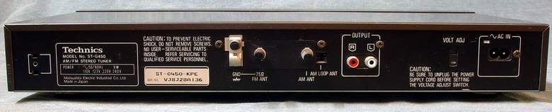

[#1] 玩fm tuner 但屋企沒有 75omns入牆插頭............
只可用300omns 拖線接地,效果好差,另一部完全收不到,現想加天線放大器或在tv入牆插頭加fm用75omns,是否要找師傅做?自己點加?是否要拖線?? 感謝!!!!!!!!!

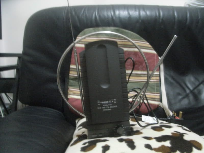

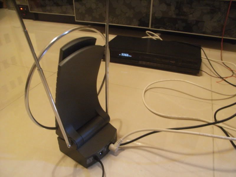

試用依個, TUNER 75OMNS OUT 去呢部天線IN,全冇反應,TUNER接收不到訊號,沙沙聲,????? THX!!
mitcvt
218.xxx.xxx.216
2011-07-08 04:21
[#14] 玩fm tuner 但屋企沒有 75omns入牆插頭............
TUNER 75OMNS OUT 去呢部天線IN,全冇反應...The antenna IN is for external antenna to use the amp on this set. You need to use the coaxial cable that built in with this antenna. Go buy a ' T ' wire antenna in SSP , cost only a few dollars. 300 ohm twin-lead termination.

You should check whether the tuner is good workig condition by using a piece of wire of at lease 2 feet long, connect it onto the tuner 75 ohm or even 300 ohm antenna unput.
Move the unit near a window and throw the wire out of the window and let the wiring hanging, you should be able to receiver stations! and see if the reception is quite good then you are laughing....report back the result, I will show you how to make an indoor antenna cheaply.

圖中依部機完全沒有作用,只有將部tuner放近窗,用75ohnms線伸出窗口先有訊號.

C-Hing 室內(booster)天線你現在白色(antenna ext)那條你駁了去tuner那裡?白色antenna ext 是否應駁去天台下來的引入線,而側邊寫住TV那條黑色的駁去你部 TUNER FM antenna 75 OHM 個度試試.(白色那條吾駁都得 將部Booster 開著佢放近窗口). 不仿試試.....

5. Connect the inner conductor of the co-axial to the antenna while leaving the outer alone.
6. This is a 75 ohm system. For 300 ohm you need to buy a 300-75ohm converter as suggested.
7. At the tuner end connect inner conductor to the 75 ohm terminal, outer conductor to ground.
8. Pull telescopic antenna to full length and swing it slightly out of the window if necessary to get the best recepton. You may need to adjust the position for different stations.
