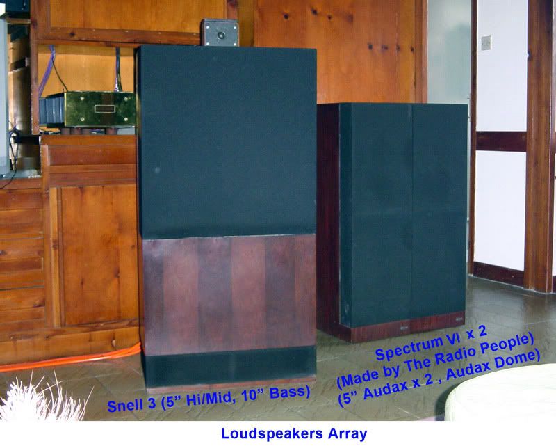

[#45] etsang3 修理好聲"山水"機一部 ttvfwong hing, I remember seeing one of its studio speakers... The Radio People (TRP) owned a advanced wood work factory in Kwun Tong (the warehouse at Shan Po Kong) those days. 2 models of TRP Loudspeakers were manufactured. They were called Spectrum V and Spectrum VI. Spectrum V is similar to LS3/5A, same size and same using KEF T27 and B110 units. Spectrum VI is quite special. An Audax cloth soft dome tweeter at the top, 1 " inner face than the woofer face, gives very musical sound. 2 5" Audax driver unit for mid-low, one outside as normal and another one sits inside the speaker body, connected in reverse polarity, its output is 3" TUBED to an opening just below the outter one. These produces a very lower freq. extension (transmission line effect), quick response with no coloration (each only 5" size) and rapid punch sound (The air in Push-pull zone in front of the speaker. You will be impressed once you hear it plays classical and jazz music. Here is the photo taken from a HiFi friend in Macau. He loves the sound but want more level so he paralleled 2 pairs. The footprint of Spectrum VI is just 12" x 12" and ~ 48" tall. ![]() |
etsang3![]() 219.xxx.xxx.64 |
2008-10-01 01:38 |

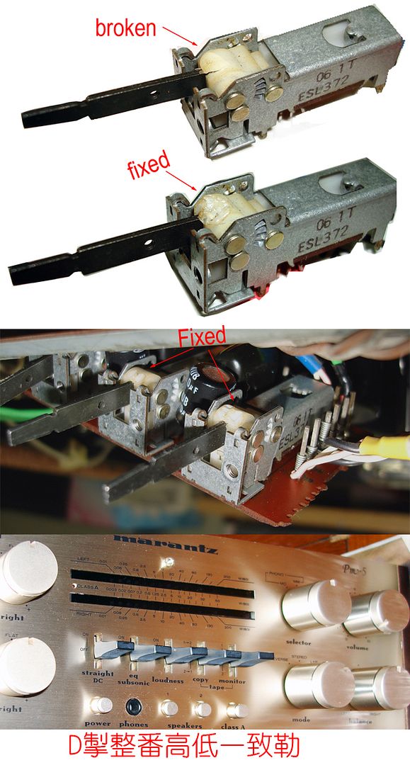

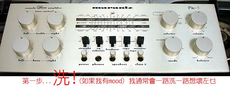

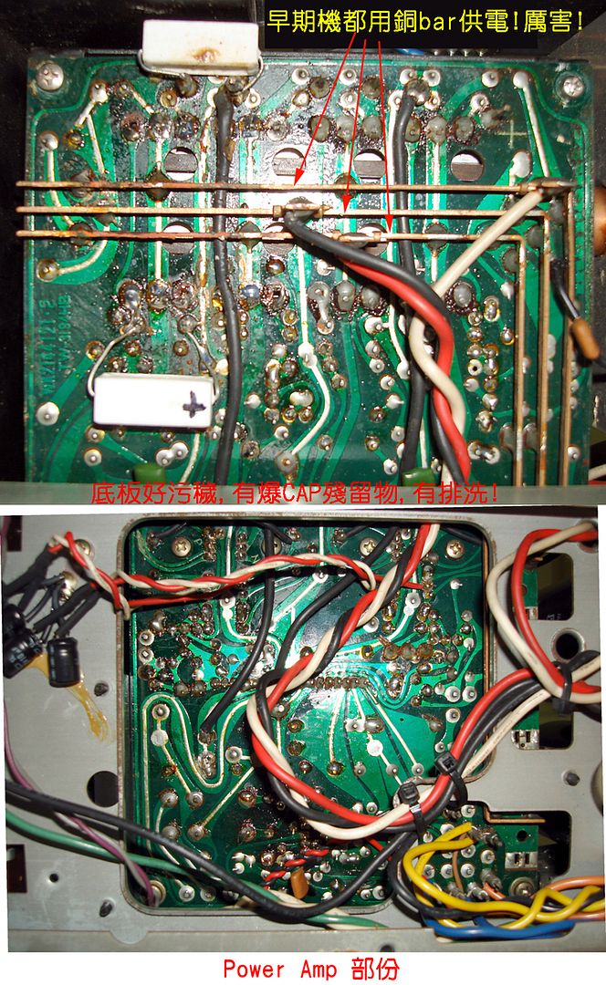

[#56] etsang3 修理 Marantz 分享 今日又拎另一網友部Marantz出黎整,又都起度同大家分享過程。部機洗過面後都好靚仔(靚樣機我會有舖"翻新引",大家要保持"污穢"look記得要同我單聲呀!) 病症 : (未開聲) 用眼睇,leveler selector 唔準. Volume刮, 有CAP爆左,底板氧化,火牛到底板有供電線斷左(咁都出到聲?) 希望我日日都有時間整下夆捸C ![]() |
etsang3![]() 218.xxx.xxx.25 |
2008-10-04 01:38 |

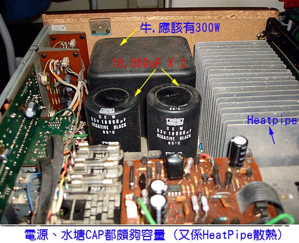

[#57] etsang3 修理 Marantz 分享 火牛、水塘都幾足架。(用料都好野) ![]() |
2008-10-04 01:40 |
[#58] etsang3 修理 Marantz 分享 早期機都有用銅BAR供電wor. 勁! ![]() |
2008-10-04 01:42 |
[#59] etsang3 修理 Marantz 分享 Leveler Selector俾人按爛左,外觀高低不一。用"塑膠師傅"(又一個我尊重李師傅,奀虴痗儠扛壅)教"辣膠",救番吽C ![]() |
2008-10-04 01:49 |

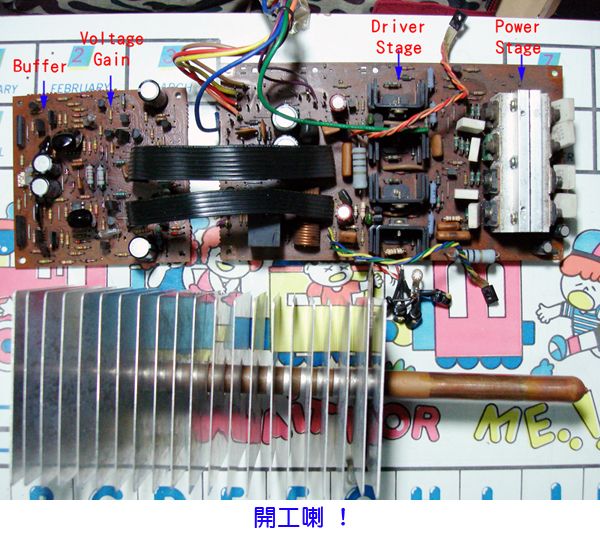

[#60] etsang3 修理 Marantz 分享 拆左十幾條線,十幾粒螺絲,終於拆左Power Amp 出黎,可以清潔同修理勒。 ![]() |
2008-10-04 01:54 |
