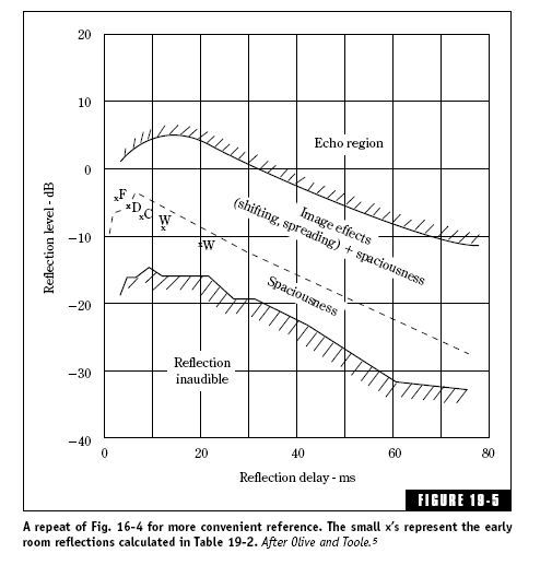

[#15] Best books about HiFi - compling a list?
This pic is about a research that differentiates how human perceive early reflections as a function of the delayed time and frequency. I found it very informative as a guidleline. Writers on the web often talks similar things in mundane language, which is good for 'introducing' us the ideas, but in the book this topic is elaborated through scientific research findings. The chart is well-presented.

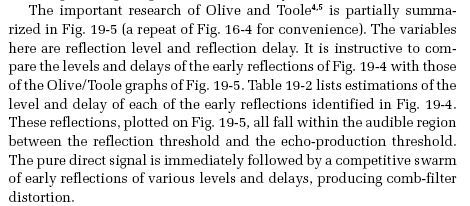

[#17] Best books about HiFi - compling a list?
As the author say, all reflections are within the audible region of our ears.
