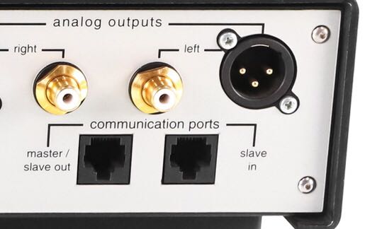

SLAVE AND MASTER COMMUNICATOR PORTS
These communications ports allow the No380S to “link” to certain compat- ible Mark Levinson components. (See “Linked Functions.”)
The Mark Levinson Linking system uses a Digital Audio Processor as the Master of (and central clearinghouse for) inter-component communications. Other components such as digital transports are connected to the Master as “Slaves,” and can be “daisy-chained” using their Slave In and Slave Out jacks. As the ultimate destination of all source signals, the No380S Preamplifier must be the final “Slave” in the chain. (In technical terms, it terminates the communications bus.) In turn, the No380S can serve as a master to an asso- ciated compatible Mark Levinson power amplifier—hence its “Master” com- munications port.
Thus, if the only other Mark Levinson Link-compatible component you have is a digital audio processor, connect its master port to the No380S’ slave port using a “straight-through” RJ-45 cable. If there are additional Mark Levinson Link-compatible components in the system, place the No380S at the end of the chain by connecting the last slave out port to the No380S’ slave port. See the diagram (left) for clarification.
The RJ-45 cable needed for the Link connection between source compo- nents and the preamplifier may be purchased from your Mark Levinson dealer. It may also be easily and inexpensively made to length using two RJ-45 connectors and the appropriate length (up to 100 feet/30 meters) of RJ-45 (flat, eight conductor) cable.
RJ-45 cables and connectors are used throughout the world for both tele- communications and computers, and are widely available at low cost. The connectors are crimped on to the ends of the cable such that pin 1 at one end is connected to pin 1 at the other end. Such a “straight-through” con- nection is (counter-intuitively) made by introducing a 180° twist in the cable between the two ends, as shown below.

The power amplifier Link connection is made using a 6-conductor Link cable. Connect the No380S’ master port to the slave port of a compatible Mark Levinson power amplifier.

how do u connect it ?
one end of RJ-45 to 38S master port and the other end of RJ-45 to CD39 slave port?
or?
u downloaded and read the manual yet?

Please download the 39 menu for a look see..... suggest doing the following:
1. Check the cable. See if pin 1 is connected to pin 1, pin 2 to 2, pin 8 to 8 etc, by using a multi-meter.
2. If cable is OK. Master out is 39 CD player, Slave in is 38 pre-amp
3. If cable is OK, power off. Then power-on 1 by 1
-- Master 39 is power on 1st
-- Slave 38 is power on 2nd
4. Follow the instruction on pg 31 (pic below)
5. Check the links by pressing the mode button pg 43
Have fun....... if not working, send an email to Mark Levinson to confirm if a normal Cat 6 cable works or not as a link communication cable.

FYI....... this is from a newer model..... (it comes with a link cable in the box I think)

one end of RJ-45 to 38S master port and the other end of RJ-45 to CD39 slave port , can't control.
I use the original RJ45 network cable,I think it should be a line problem.
