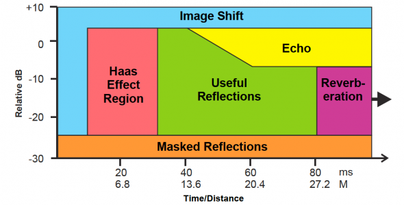

用兩對喇叭去改善音場,最重要是Haas Effect的應用,如果不將輔助喇叭延後發聲,誓必影響音像的準備度,兩聲道音像由左右喇叭形成,多加一對的話,令音源由兩個加至四個,音像自然受到影響。只有將輔助的一對發聲延後5ms以上,音像就只由一對主喇叭造出來。
The Haas effect, or Precedence effect has been well known for many years. It is a psycho-acoustic effect related to the ear’s localization of sound. Simply stated, when two identical sounds from different sources arrive at the ear with only a small time difference, the ear will localize the sound as coming from the earlier source only. This is a quite natural everyday occurrence. The direct path from a sound source to the ear is the shortest and always arrives first. Later a reflected copy of the same sound may arrive at the ear after having traveled farther and reflecting off the floor, wall or ceiling. Our ear correctly identifies the first arrival as the direction of the sound source. What is somewhat surprising however is that the later arrival can actually be higher in level than the original arrival, and our ears will still insist that the sound is coming from the first source.
最後修改時間: 2013-05-21 15:29:41
hkborn
112.xxx.xxx.16
2013-05-21 15:26
[#16] 改善音場深度和寬度
若然早就出現這理論,又一向用於舞台音響,這方法用於家中的音響組合,又會有甚麼好處...
先看以下的資料,正是原理及運用的文章,說明了與AV ,單元相位排列 (我自已玩相位加Haas) 的原理是不一樣的..
(Haas effect)
(Haas)通过实验表明:两个同声源的声波若到达听音者的时间差在5~35ms以内,人无法区分两个声源,给人以方位听感的只是前导声(超前的声源),滞后声好似并不存在
若延迟时间 在35~50ms时,人耳开始感知滞后声源的存在,但听感做辨别的方位仍是前导声源
若时间差50ms时,人耳便能分辨出前导声与滞后声源的方位,即通常能听到清晰的回声。
Haas 对双声源的不同延时..给人耳听感反映的这一描述,称为Haas效应。这种效应有助于建立立体声的听音环境
当两个强度相等而其中一个经过延迟的声音同时到聆听者耳中时,如果延迟在30ms以内,听觉上将感到声音好像只来自未延迟的声源,并不感到经延迟的声源存在。当延迟时间超过30ms而未达到50ms时,则听觉上可以识别出已延迟的声源存在,但仍感到声音来自未经延迟的声源。只有当延迟时间超过 50ms以后,听觉上才感到延迟声成为一个清晰的回声。这种现象称为哈斯效应,有时也称为优先效应
指人们不能分辨出某些延迟声的现象。延迟声的声压级小于先导声,无论来向如何,只要小于17ms,就不会感到延迟的存在。当延迟声的方向接近先导声,延迟30ms也不会感受到。只有大于50ms时,人们才会感受到延迟声。
