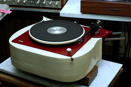

我用緊個Lenco L75盤,已經有2個月小弟對這個唱盤有小小感受想同各位分享!如果反尼唔做保修的話其實在今天嘅唱盤水平尼講是不合格嘈音大!一般人稱之為(轆聲)重有個摩打張三條彈弓直接上落塊薄薄的鉄板處一,由摩打諧震徑膠轆傳上轉盤!二,由軸心再張摩打産生的諧震傳上轉盤!以上兩個途徑+迷一起!三,本身木座非常單薄無法張諧震降低!..咁点可能唔嘈呢?我記得第一次同個盤做保養時張軸承及膠轆軸拆出清洗後再重新落油之後再聽反已經效果非常正面!跟住再張摩打調較好後得出來嘅較果非常拎人興奮!現在連咩轆聲都不易擦覺了!如果再為她做一個好的木座小弟相信會有另一個新天地!

I am using Lenco Goldring GL75 and GL78 and yes there will be 轆聲 and there is room for improvement.
For more information with regards to Lenco Idle Wheel Transcription Turntable there is a web dedicated to it and it's called www.lencoheaven.net
There are many users in Hong Kong as well as around the world. Daiwok is one of the web administrator and he is in Hong Kong.
If you register with them you could see how people modify their Lenco's in order to improve, just everything.
The common motion will be building multi-layer plywood plinth with improved idle wheel, insulation under the platter and new blocks with the original arms.
If you want further you could build a PTP5 or PTP6.
As for myself I have used heavy slate, solid oak, rosewood, double plinth and double platter. They all give you different sound signatures and dare I say FUN!!

ckh035兄!同各位C兄,我都係跟D大C兄玩!各位有興趣可上www.lencoheaven.net睇睇人哋点玩!
玩唱盤同玩其他環節都一様係講点配合(夾)睇吓你口味要D咩!
雖然小弟玩L75玩咗一段很短時間!但這盤比我的反應很直接!仲有很多空間去有待發掘!
這盤聲音很全面因為同她的驅動platter方式有关!(聲音非常有力同熱情)値得一玩!
各位如果對L75有興趣的話可(留電交流交流)
