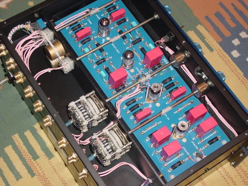

This one off Matisse Reference belongs to my friend, who is also the inventor of the "Conductor". And this specially made item is using the best sorted components and have a golden plate embedded inside the chassis with his name marked on it!

This one is ok partially using top grade PRC.
However, the one in 2nd hand market is even more preferable with top grade PRC in every position except plate resistors.
Notice the Wima coupling caps are bigger in 'Golden Version'
