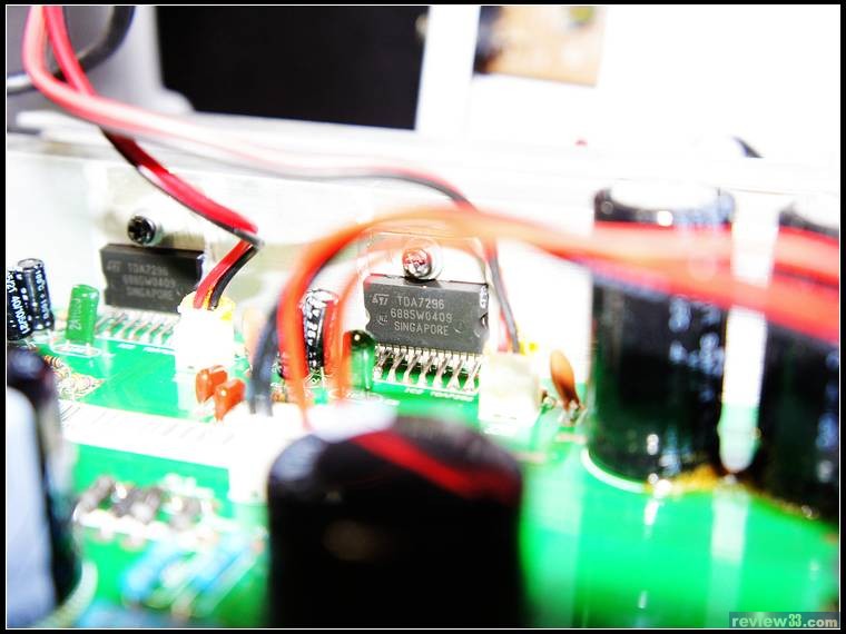

[#9] 超Cheap次貨膽機摩摩改改~~~~~~好正又頂癮!!!
TDA7296後級的放大。
內部用料(網上圖)
[img]https://upload.review33.com/images/201308/201308251623402961.jpg[/img役
