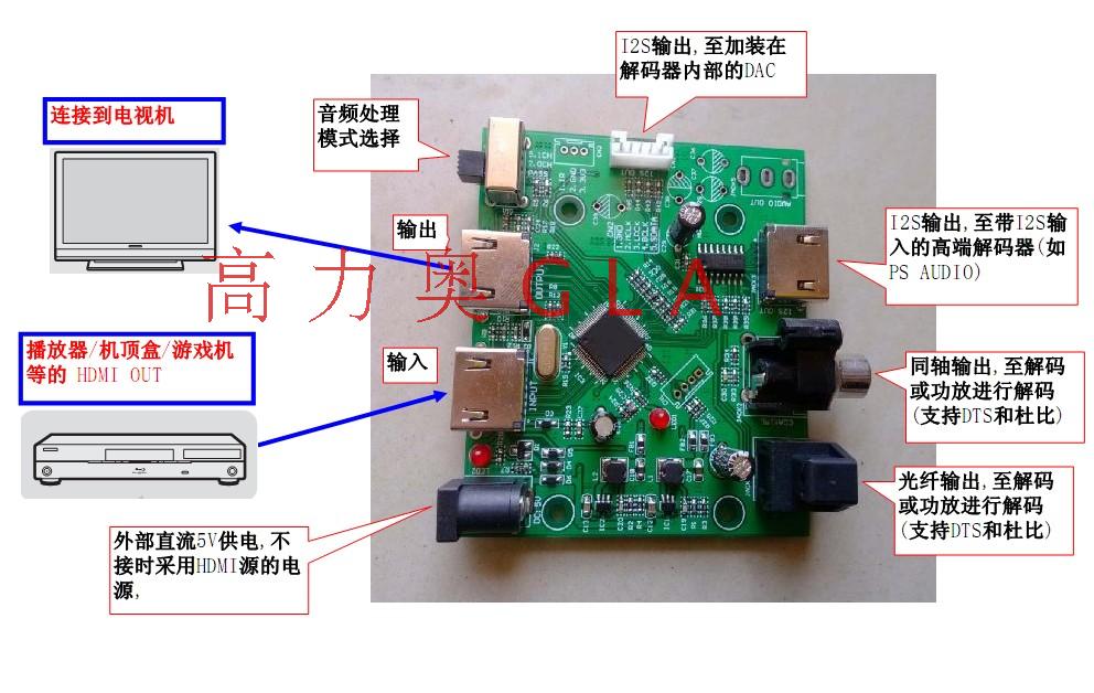

[#4] HDMI I2S to SPDIF or AES/EBU
#2
剛剛揾到樣咁既野,唔知work唔work
唔知佢個同軸係咪DoP
HDMI/MHL双模 分离提取音频I2S/DSD/光纤/同轴 (HDMI转I2S/IIS)

[#5] HDMI I2S to SPDIF or AES/EBU
我有用緊,睇戲時先用佢的 i2s out。不過唔知係咪 DOP。

[#6] HDMI I2S to SPDIF or AES/EBU
我都用緊...主要在Hdmi抽出i2s訊號,
全改高精準時鐘,頻率比原裝高出差不多一倍,
聲音密度更高,細節豐富,動態更強!

[#8] HDMI I2S to SPDIF or AES/EBU
師兄搵師傅將原裝粒鐘24Mhz換成40Mhz,而粒40Mhz就豐儉由人,
我換幾十蚊TCXO
