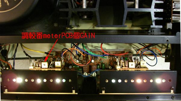

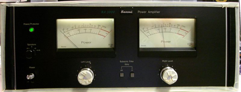

SANSUI BA3000
(1) 一邊METER低
(2) 一邊有NOISE
又係100V!不過D大CAP都仲"好眉好貌"
火牛水塘(先天)都唔差,不過如果完全雙份會更好。

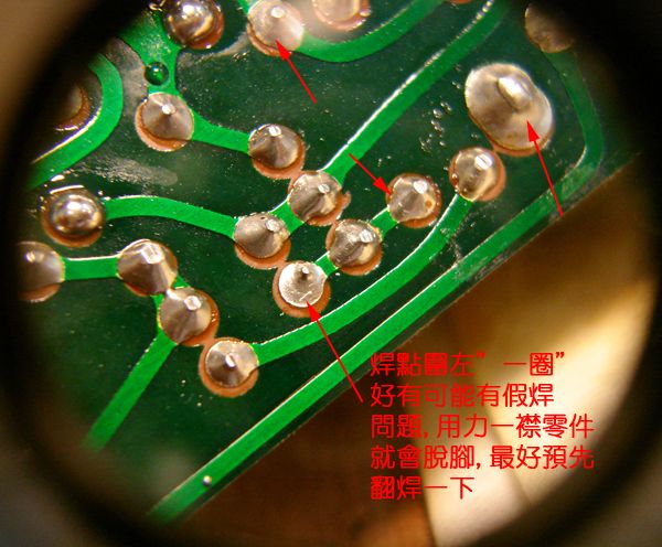

[#4] etsang3 修理 SANSUI BA3000
好勒!開工勒。老機...有不少"假焊"...執..執..執..
好不辛苦。
要執到敲打底板時時波器上無雜音為止。

[#5] etsang3 修理 SANSUI BA3000
表頭較番balance
etsang3
219.xxx.xxx.241
2009-08-24 01:34

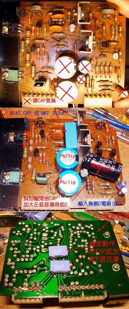

[#6] etsang3 修理 SANSUI BA3000
還原底板插青春
etsang3
219.xxx.xxx.241
2009-08-24 01:35
[#7] etsang3 修理 SANSUI BA3000
主底板換走舊CAP,再少少補一補啦
etsang3
219.xxx.xxx.241
2009-08-24 01:35

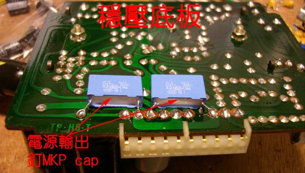

[#8] etsang3 修理 SANSUI BA3000
穩壓板換CAP+MKP
etsang3
219.xxx.xxx.241
2009-08-24 01:36

[#12] etsang3 修理 SANSUI BA3000
hinhin兄,我記得,佢抬左番公司修理,佢個主驅摩打燒左一邊線圈,搐下搐下,要搵到個摩打換至得。佢咁舊可能搵唔到勒。

[#18] etsang3 修理 SANSUI BA3000 (UNIT # 2)
另一R33友嘅,BA3000,佢仲比埋部MOD到壞哂嘅CA3000我整添。呢部BA3000(100V)都係BIAS失調同埋零件老化咁啦。
一開波就換哂D新零件先再試啦。輸入換左粒靚10uF(BP)再釘粒0.1uF(MKP)起底度,應該會更通透勒。
開機。調好BIAS。調好對METER。"焚"機幾日,哎!發覺一邊D老管漏電(個身發哂霉)出DC飄移,要換勒。

[#19] etsang3 修理 SANSUI BA3000 (UNIT # 2)
tsang sir,
i have zero knowledge on electronics. but just interested to know ...
I saw from above pictures that you add some X2 class noise suppression capacitors. What are the purpose of these X2 class capacitors in the circuit ? it seems you are not trying to filter out high frequency noises.....
Sorry for my navie question
Tks a lot for comment !
(I saw X2 class printing on the "MKP cap" photos, the blue box type capacitors)
最後修改時間: 2010-01-04 21:25:00
numbertwo
221.xxx.xxx.16
2010-01-04 21:22
[#20] etsang3 修理 SANSUI BA3000 (UNIT # 2)
X2 class MKP can pass (or shunt) Pulse signal (or called noise) to ground. For bi-polar ecap (below it), even it is very good quality (i.e Blackgate) its inductance effect causes it impedance increase over 10kHz. Thus, high freq. >10KHz starts to roll off of using ecap alone. The MKP here add another low impedance path from high to very high freq. to backup the ecap. To make the ecap more like an ideal cap. (The higher the freq the low the impedance to 100kHz)
