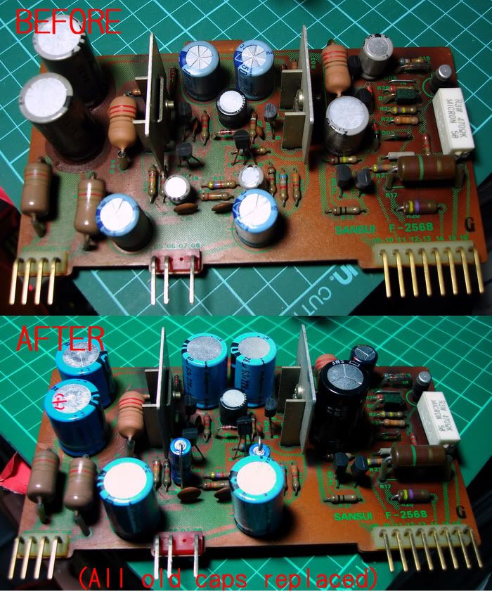

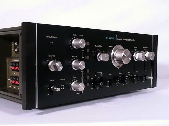

[#1] etsang3 修理 Sansui AU9900
呢部AU9900好似起樓上跌左落黎一樣,破壞得都好厲害!
100V機應該又係被人插過落220V,最近收左好多日本二手病人都係咁!!!

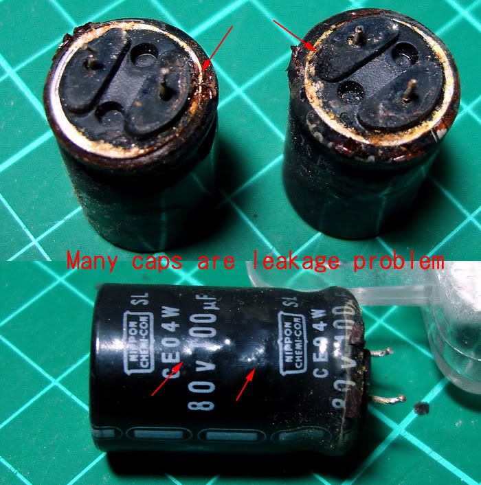

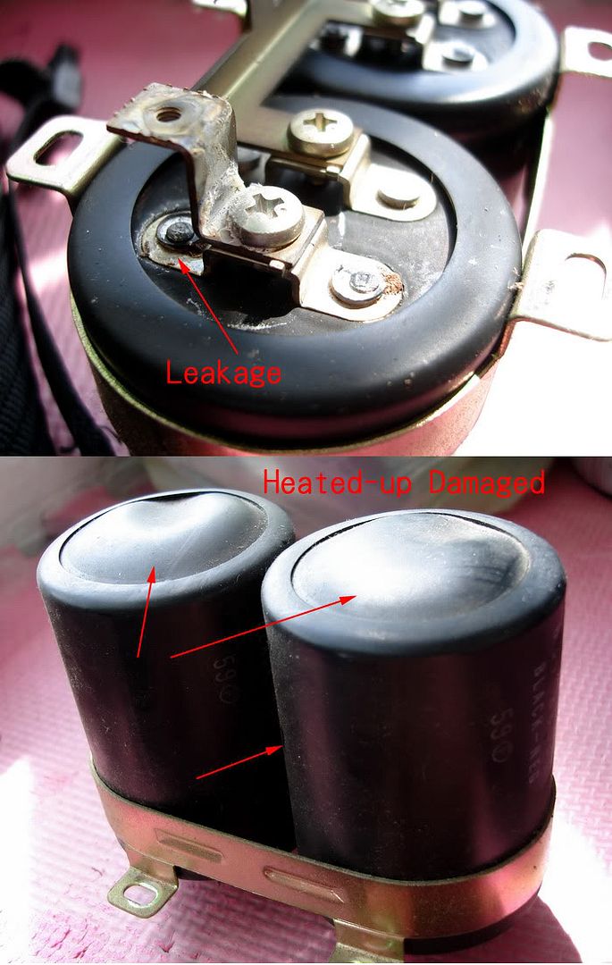

[#3] etsang3 修理 Sansui AU9900
大CAP又有爆漏!!! (估計"過壓"導致"高溫"所致。)
etsang3
203.xxx.xxx.38
2009-08-13 08:27
[#4] etsang3 修理 Sansui AU9900
底板上有不小CAP刀都爆、漏,染污底板。
etsang3
203.xxx.xxx.38
2009-08-13 08:29

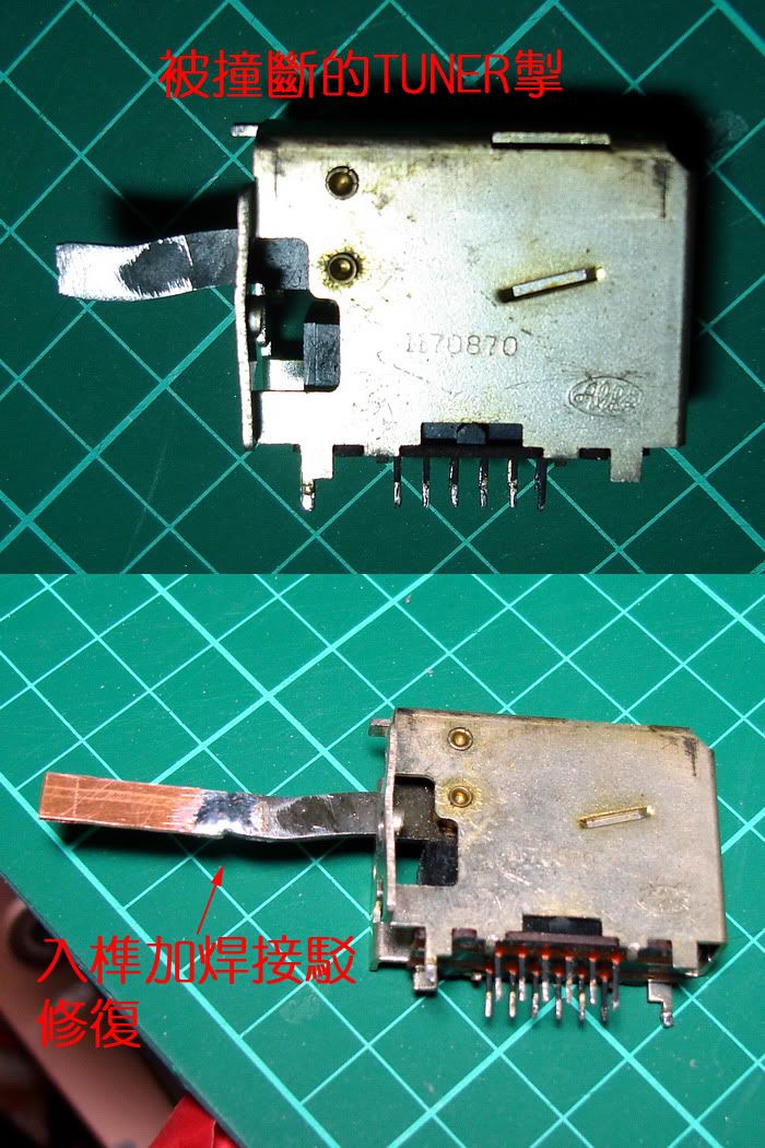

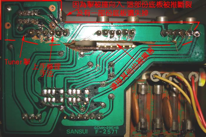

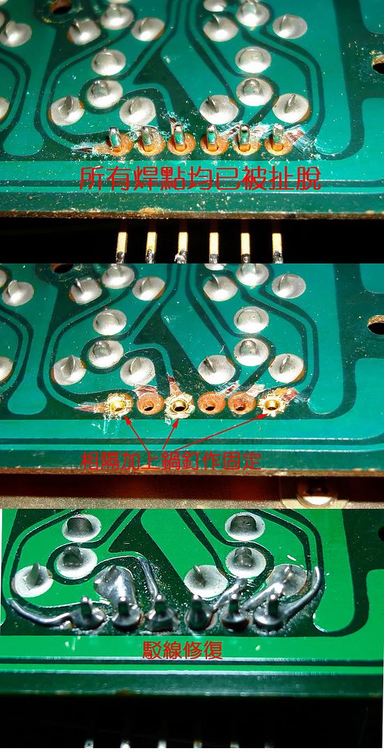

[#5] etsang3 修理 Sansui AU9900
好啦。開工修理。
修斷左TUNER掣。
etsang3
203.xxx.xxx.38
2009-08-13 08:31

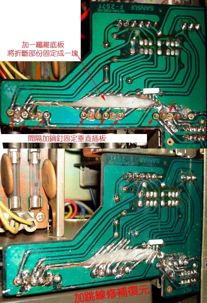

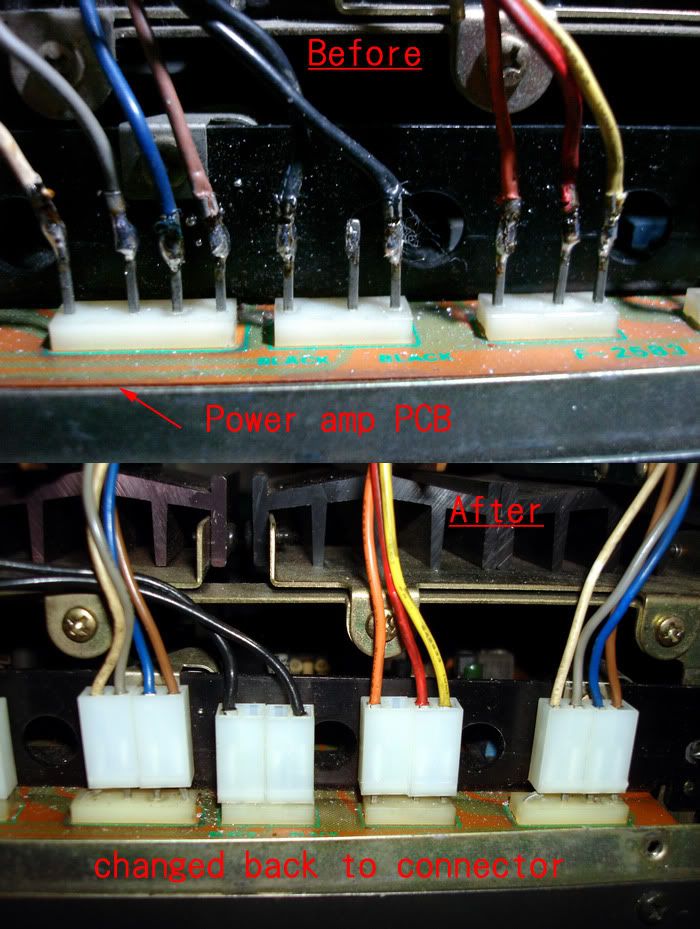

[#6] etsang3 修理 Sansui AU9900
輸入底板接腳。
etsang3
203.xxx.xxx.38
2009-08-13 08:32
[#7] etsang3 修理 Sansui AU9900
修復斷左TUNER掣底板。
etsang3
203.xxx.xxx.38
2009-08-13 08:33

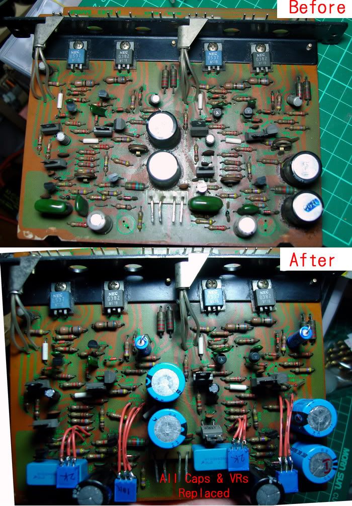

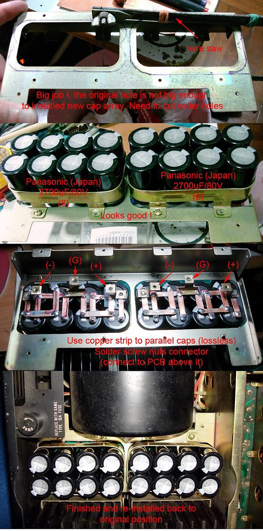

[#8] etsang3 修理 Sansui AU9900
嘩!哩個慘痛咯!要改機。不過加大左,好好聲。
(6800uF -> 2700uF x 8)
etsang3
203.xxx.xxx.38
2009-08-13 08:35
[#9] etsang3 修理 Sansui AU9900
Master etsang3 great job but would the copper trip touching each other and short the CAP?? why not replace with cap of same size?
wo
220.xxx.xxx.63
2009-08-13 08:46

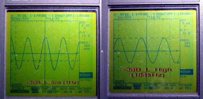

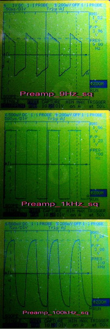

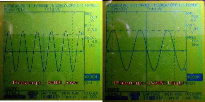

[#18] etsang3 修理 Sansui AU9900
早晨呀etsang3兄,
check膽前有沒有漏DC,是否度output,DC幾多先正常?
THANKS!
chi1673
116.xxx.xxx.208
2009-08-13 09:01
[#19] etsang3 修理 Sansui AU9900
Wo hing
----You may not see. There are very think High Temperature PE tape (Transformer tape) covering each copper bar,
---- I asked my usual component shops. No such fit size. Also, this is an old 2nd hand amplifier. The budget is ~$300 for that. ecap like Rubycon and Elna are out of the budget.
chi 1673 hing
Test the DC at the Tube Preamp output RCA socket.
It should be lower than 10mV (0.01V) or even lower.
