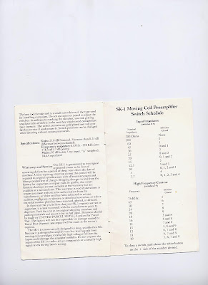

[#10] **求救**Klyne 蜻蜓 SK1 MM 放大阻抗表
Oops, here is the photo, but it looks like you have to go to the Blog and click on pic to enlarge it.

[#11] **求救**Klyne 蜻蜓 SK1 MM 放大阻抗表
doctorjohn hing,
Thankyou!
