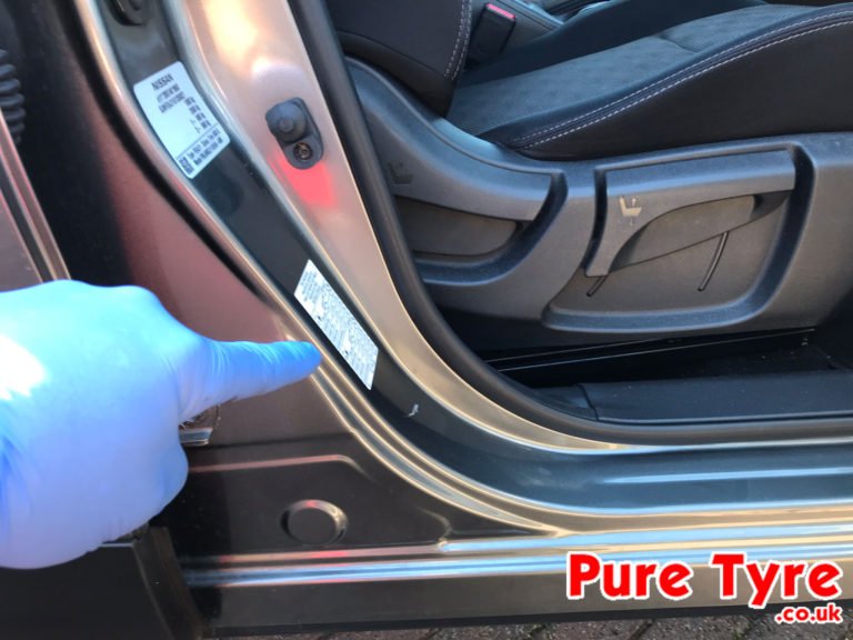

請問呢款車打呔氣幾多psi較好? Thanks!
奸人堅
94.xxx.xxx.236
2022-05-10 04:40
[#38] Nissan New Qashqai
#37.請問呢款車打呔氣幾多psi較好? Thanks!
>>> 32-38psi
CS168
116.xxx.xxx.198
2022-05-10 16:51
[#39] Nissan New Qashqai
車門邊應有 label
最後修改時間: 2022-05-10 18:30:11

[#40] Nissan New Qashqai
#38
CS168
唔該晒, 我打咗4條都係35psi試下先.....
