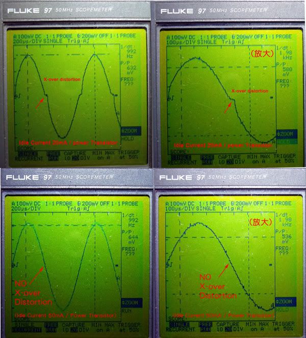

[#21] etsang3 修理 Marantz PM5
wo hing,
the fixed BIAS resisters I mean are the 4.7k and 15k (near the Class A switch) above.
After the Power Transistors are replaced, the voltage drop across the Re (usually 0.2Ωto 0.5Ω at the E leg of power Transistor) must be checked.
e.g if it is 0.22Ω/5W resistor and a bias current of 100mA (0.1A) is running. The voltage measured at the resistor's 2 ends will be 0.22 x 0.1 = 0.022V=220mV. To ensure there will not be crossover distortion due to light BIAS. I always adjust the BIAS to 200mA (idle current).

[#22] etsang3 修理 Marantz PM5
Ok, etsang3 sir
Assume the 0.22ohm resistor is normal, in case the voltage across 2 legs of 0.22ohm resistor is not 200mV, that mean we have to adjust either the 4.7k or 15k ohm in this case?
Also, 200mA (idle current) is universal or should refer to transistor spec?? I have impression some amp requie 300mA for this (school time amp...) THX
wo
58.xxx.xxx.90
2008-10-27 01:06
[#23] etsang3 修理 Marantz PM5
....that mean we have to adjust either the 4.7k or 15k ohm in this case?
>>Yes. The higher the resistor value the higher the BIAS current will be.
Also, 200mA (idle current) is universal or should refer to transistor spec?? I have impression some amp require 300mA for this (school time amp...)
>>Ng~ I think the minimum is 100mA. Lower than that you can "SEE" Crossover Distortion at the CRO. You can set to 300mA or even higher and the sound will be better provided the heatsink is OK to keep the temp. below 60C.
When Power Transistor reach that temperature, its power handling capability (before it die) actually dropped to half of the spec.
etsang3
202.xxx.xxx.193
2008-10-27 13:19

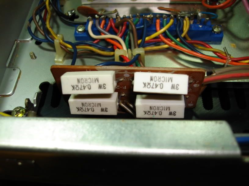

[#33] etsang3 修理 Marantz PM5
ECC83兄,
可否打開裴ost一D相上黎睇下呢?一般黎講,牛在中央,機內佈置左右對稱,機外左右雜物阻擋氣流一樣,左右散熱器的溫度應是一樣的,左右散熱器溫度不衡會是偏流(BIAS)失調所致,你有他表的話可以量度每個"輸出管"的瓦阻(白色方型電阻)兩端得出的電壓降,看看是否一樣(+/-10%內)。
注意:在不開電的情況下用苳M刮得各電阻腳一般乾淨,以方便量度。電表設定在DC=2V檔(一般會量得0.01-0.1V),量度時小心不要踫到其他零件腳,上身不要帶金屬物(手錶、頸鍊等),如果你是"新手",最好帶埋膠手套。
