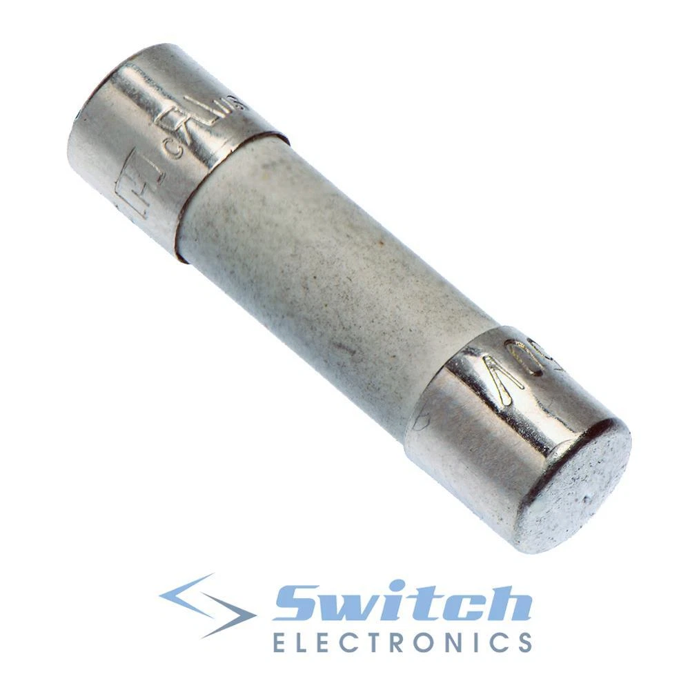

The day I left the UK for HK for my trip my QUAD 606 had the right channel down. However I didn't have the time to look into it until today.
As suspected the 3A slow bow on the right channel had blown and that also affecting the on/off green light on the front panel.

So your QUAD 606 is back on working after replacing the 3A fuse?

Yes, it was a simple job of opening up the base(with heat sink) and you can see the caps with the fuse slot.
I went to the only shop which stores electrical parts and they only have 2A slow bow fuse so I use them for the time being until I get the correct 3A fuse.

Looking to replace the fuse inside the QUAD 606 and I found that there are glass and ceramic fuses.
What do you guys prefer?

#6192
Ceramic fuse preferred. And get bussmann if it is available. :)
