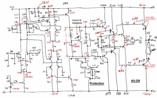

[#6] etsang3 修理好聲"山水"機一部
6. 線路圖
http://i20.photobucket.com/albums/b206/etsang3/AUD9/Powerampcircuit.jpg
etsang3
219.xxx.xxx.120
2008-09-29 00:20

[#14] etsang3 修理好聲"山水"機一部
* The front transistors were not changed.
* The Volume changed to a better one.
* The Power Transistor problem must be fixed and changed to a better pair and same Sanken maker higher power (also higher safety).
* Higher BIAS has been set for better sound (the power transformer and storage caps of this Sansui is very powerful and in good condition so can support that)
* The faulty caps on the board has been changed.
I think the so called "Sansui" sound can be maintained and will be improved. Let's the used check and tell me the result.
etsang3
218.xxx.xxx.192
2008-09-29 08:11
[#15] etsang3 修理好聲"山水"機一部
菱形差動,山水拿手鑽石線路,今日的Accuphase 都係"抄"吽C
風水輪流轉,好似音響/diy界又開始吹膽轉石之風。
thomasc2
202.xxx.xxx.161
2008-09-29 10:33
