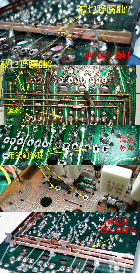

[#5] etsang3 修理 Marantz PM5

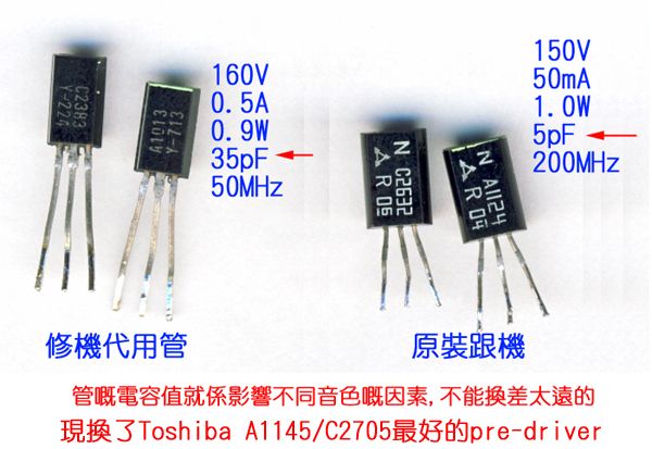

哩部機其實比一間頗出名公司HiFi修理公司整過,機主話唔知點解,呇aCUT鱄笏lass A 掣弁,CUT鱄茩悸OLED VU 錶CUT弁,
我睇黎都要化D時間還原"真身",嗚~部機靚樣又幾真才實料,不過堶扈u係要大執"咿R",我工作仲係咁忙,要整多兩個星期都似勒,
希望機主了解啦。
"大清洗"

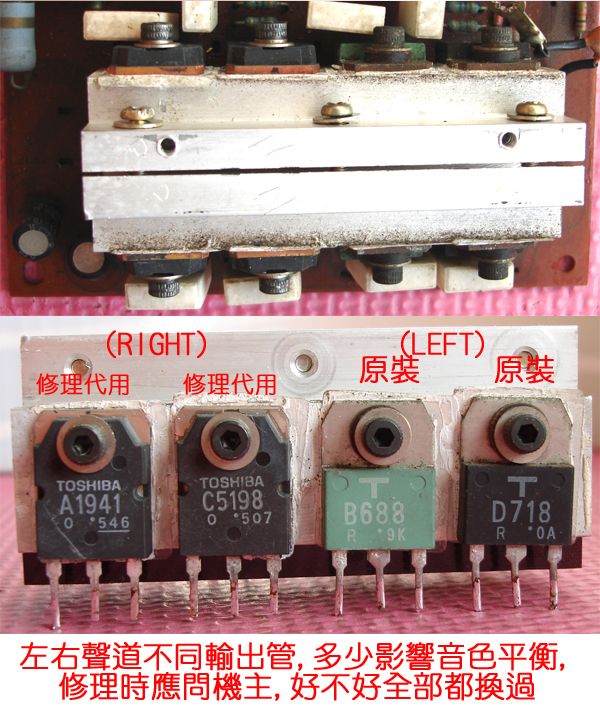

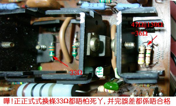

[#8] etsang3 修理 Marantz PM5
* 換入音色不匹配管
* 唔換入正式正確數值電阻
* 一邊聲道換入代用輸出管,又唔通知機主及問一問要否全部換哂,達至音色最平衡

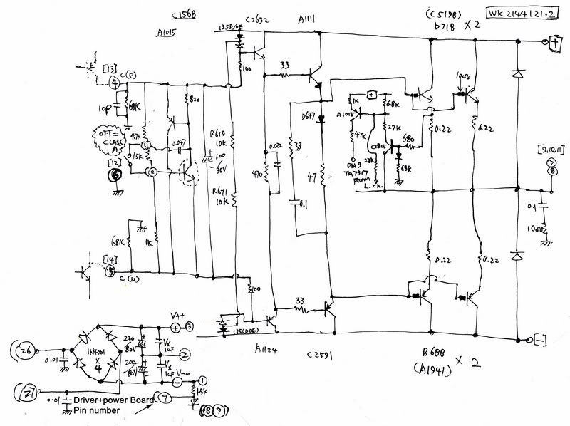

[#16] etsang3 修理 Marantz PM5
wo hing,
you means this PM5 ? There is no VR pot on the board to adjust the BIAS wor (?) It is using fixed resistors for BIAS. (I will post the whole circuit after I clean my drawing). And a switch called CLASS A seems to make the BIAS a little bit higher. Based on only a heat pipe heatsink, I don't think PM5 can be real CLASS A amp. Also the power supply section is not enough to support CLASS A.
etsang3
218.xxx.xxx.49
2008-10-26 12:35

[#18] etsang3 修理 Marantz PM5
etsang3 hing, not just PM5 but typical power amp circuit.
Back to PM5 type, "fixed resistor" (you did mention the 33ohm). how should user measure after replace the power transistor?
Also, the high power rating resistor (big size) alway cause problem, what the use of this resistor uausally?
** Sorry for too many questions **
wo
210.xxx.xxx.122
2008-10-26 16:55

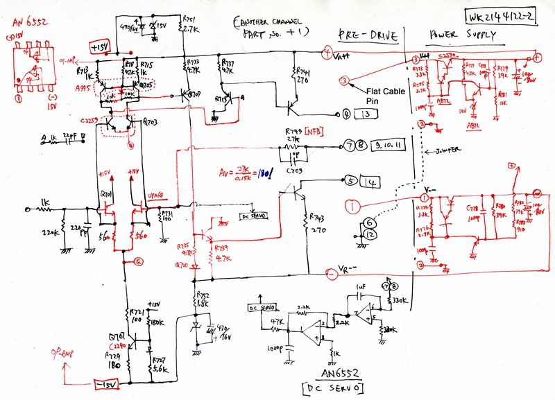

[#19] etsang3 修理 Marantz PM5
PM5 power amp section circuit 1/2
etsang3
219.xxx.xxx.159
2008-10-26 18:13
[#20] etsang3 修理 Marantz PM5
PM5 power amp section circuit 2/2
etsang3
219.xxx.xxx.159
2008-10-26 18:13
