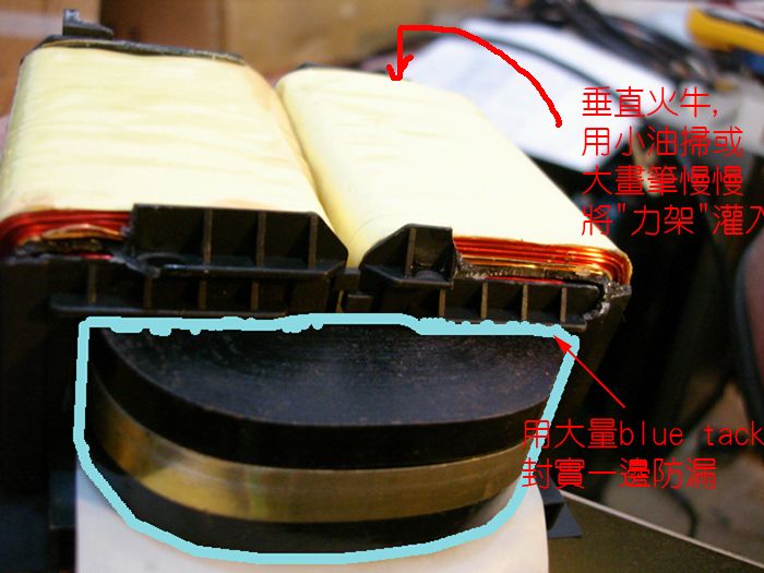

[#3] etsang3-談修理問題
B750的常出現病症,我用這方法搞好過,可以一試。
1. 去五金舖買最細罐"力架"
2. 去書局買 blue tack
http://www.artskills.com/images/big/postertack.jpg
3. 用大量blue tack把火牛一邊封住防漏
4. 垂直火牛,用小油掃或大畫筆慢慢將"力架"灌入
5. 第一天入一半
6. 待風乾兩天後,再灌入至滿溢
7. 再風乾兩天後試試,合上B750蓋應聽不到hum聲了

"""""1. 去五金舖買最細罐"力架" """"
灌火牛應用凡立水(varnish),用力架有溶解漆皮的可能/風險。

Lacquer 俗稱力架,快乾,要用天拿水開稀,一般油木器用。
Varnish 凡立水,俗稱光漆,慢乾,用松節水稀釋,一般補牆紙打底用,電工界用來代替正式的絕緣漆泡火牛。

>lacquer = varnish => X X X X X X X X X X !
lacquer / "力架" 屬低溫易燃品,只可以用於機殼外(塗)層保護,"浸火牛"用途 一定唔合規格,危險動作,請勿試!
"浸火牛" 要用 varnish。最好抽真空再高溫焗!過程一樣要好小心。

"""is that right? that is pretty dangerous"""
No kidding. Nowadays almost all transformers are soaked with the much cheaper varnish instead of real 絕緣漆. The red coating you see on those antique transformers, such as those so called British 紅牛 is real 絕緣漆.
