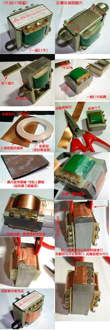

[#1] etsang3 DIY 銅腰帶屏蔽火牛漏磁
見有問哩樣,又唔難DIY,做俾大家分享下。
仲有一個效果好好多,又簡單技術,就係.....
"機牛分體"

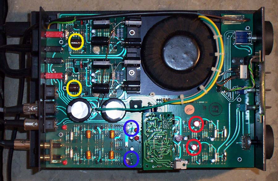

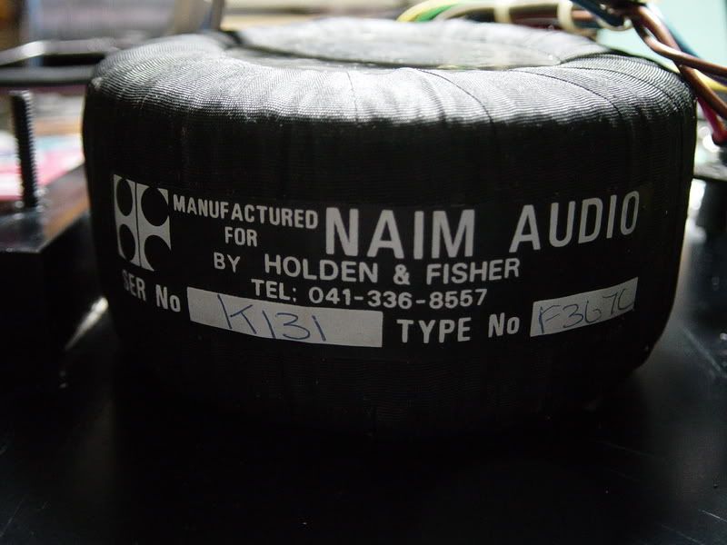

[#6] etsang3 DIY 銅腰帶屏蔽火牛漏磁
etsang兄,其實我問題係隻牛令到起hum,已經試過將牛轉角度,但係轉角度有限,所以想包住隻牛...

[#7] etsang3 DIY 銅腰帶屏蔽火牛漏磁
環牛漏磁最勁係邊間,頂同底係漏得最少,所以維邊包住就最好。

[#8] etsang3 DIY 銅腰帶屏蔽火牛漏磁
kimming hing,
你部係NAIT-2
我都有幫朋友摩過部NAIT-2.
隻牛質數好高個渦, 試下回答我d問題等我唸唸...
1. 起喇叭聽到HUM? or
2. 甩左喇叭烘隻耳埋牛身聽到HUM?
3. 甩哂TAPE,AUX,TUNER,PHONO cable仲有無HUM, 係咪重係檔檔都有HUM ?
要注意原庄NAIT amp,係一定有小小HUM架(AUX檔,volume=max,烘隻耳埋喇叭聽),奀o6800uF x 2 濾波電容成部機用,一粒豆仔LM317就比Phono同Line amp用,加D R+C濾波電路稍作分隔。
如果不嬲都係小HUM,近來突然大左,可能LM317晌左勒
資料供你參考

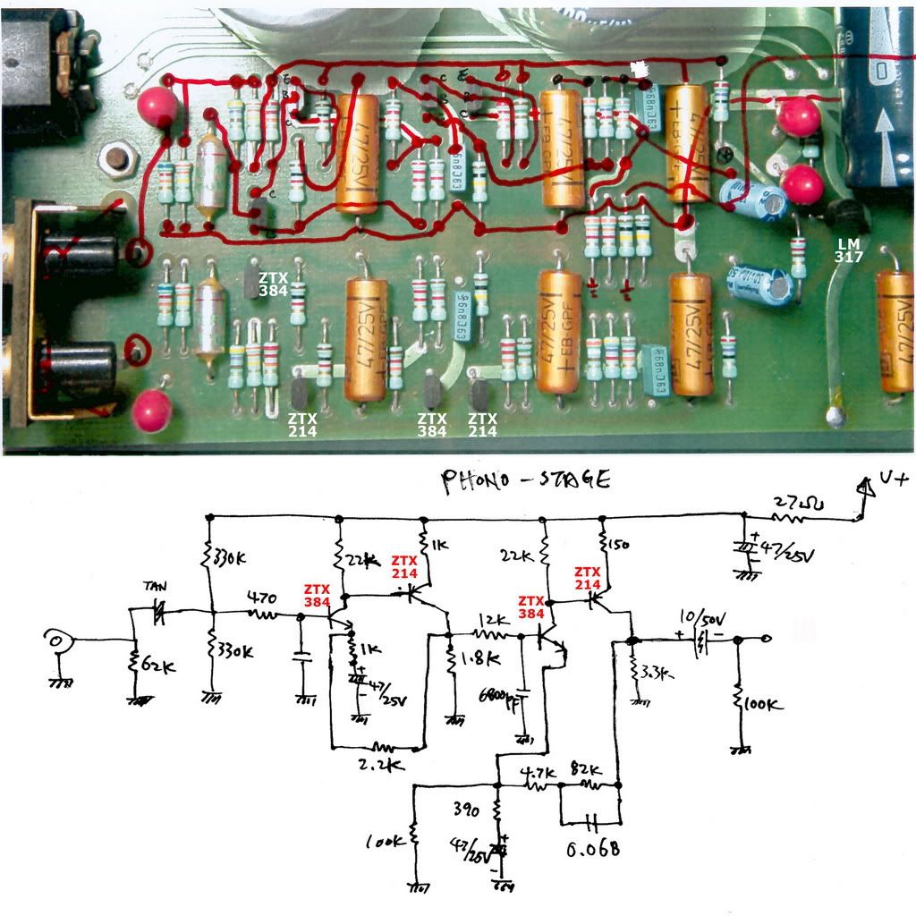

Phono amp
http://i20.photobucket.com/albums/b206/etsang3/Naim/PhonoStage.jpg

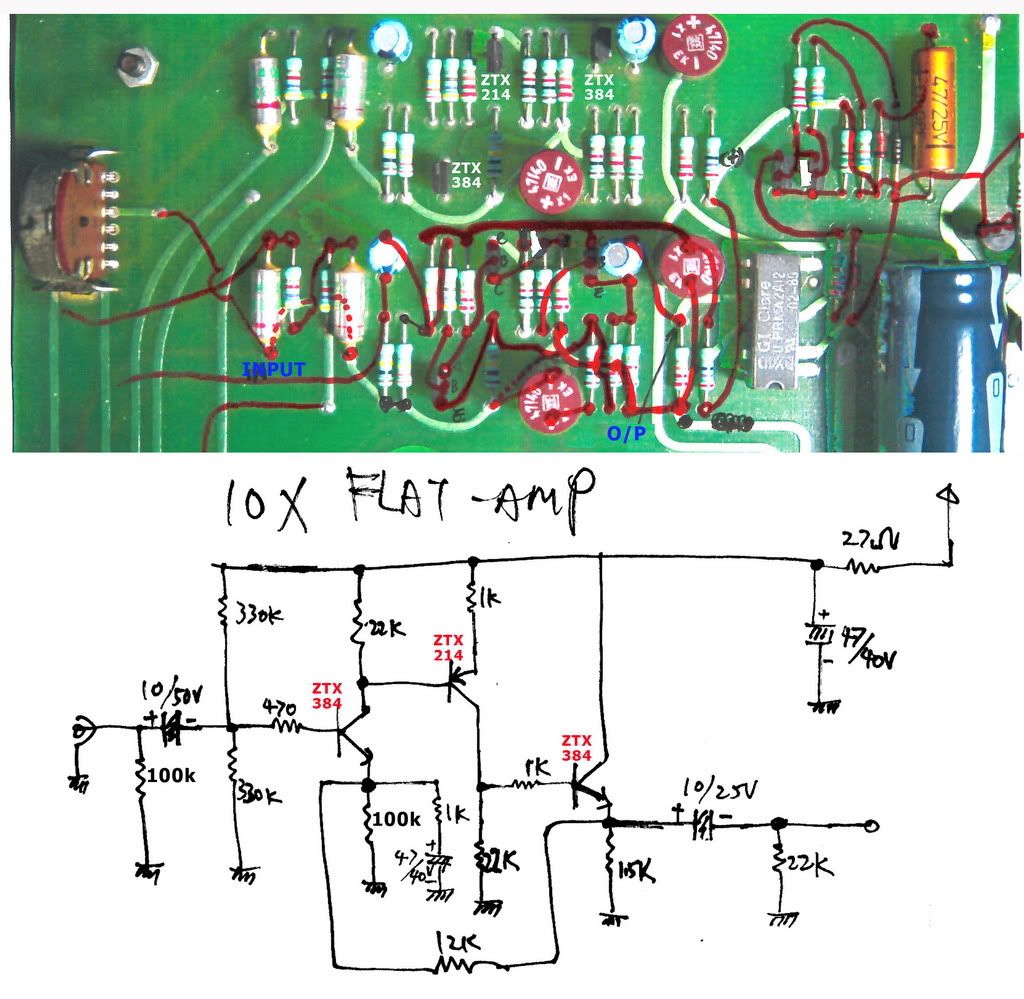

Line amp
http://i20.photobucket.com/albums/b206/etsang3/Naim/10XFaltamp.jpg

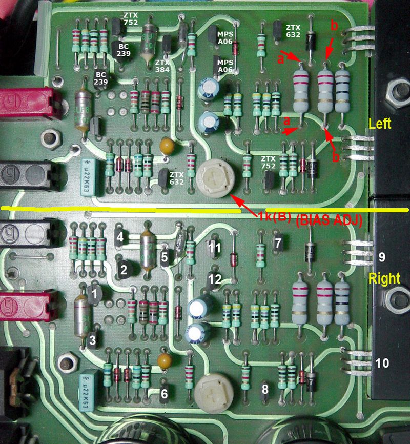

Power amp
http://i20.photobucket.com/albums/b206/etsang3/Naim/Poweramp-AA-1.jpg
http://i20.photobucket.com/albums/b206/etsang3/Naim/Power-amp-circuit.jpg

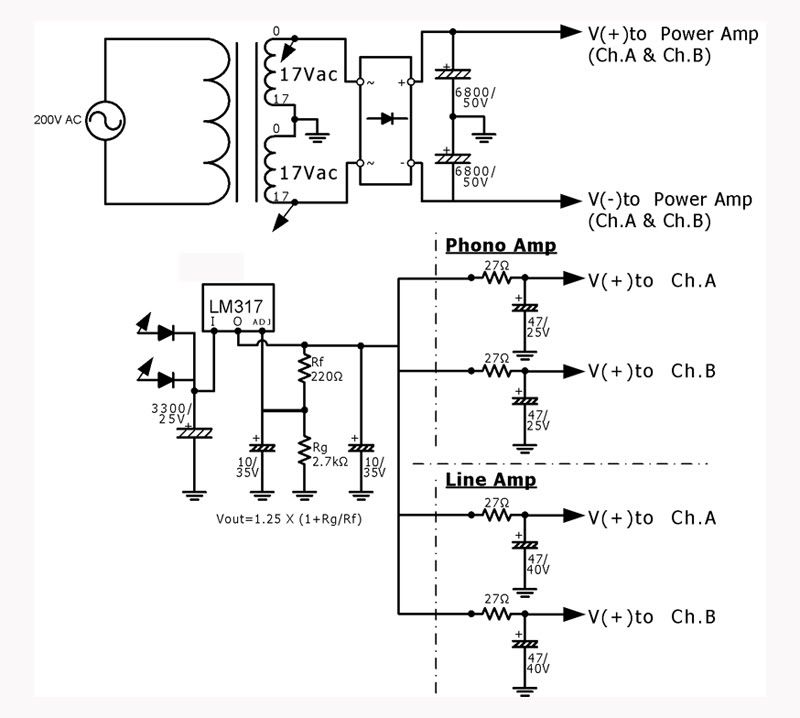

Transformer and Power Supply
http://i20.photobucket.com/albums/b206/etsang3/Naim/NAIT2Transformer.jpg
http://i20.photobucket.com/albums/b206/etsang3/Naim/PowerSupply.jpg

[#9] etsang3 DIY 銅腰帶屏蔽火牛漏磁
etsang3 兄
小弟diy用的EI 牛, 全部都有用這方法處理,
我用的是錫貼紙, 我通常都會十字型的橫直都繞一圈.
我還有一點要補充, 洗用貼紙型的銅或錫鉑,
因為金屬的一面有膠v緣, 所以要注意不能方死蝕底的繞幾圈或以, 否則會起電感, 仲會有煙冒出架 . ^^

[#11] etsang3 DIY 銅腰帶屏蔽火牛漏磁
estang兄,我部nait2係完全冇input情況下,都有hum聲,甩左喇叭烘隻耳埋牛冇hum,比過樂聞check,師傅話係隻牛影響,所以先會諗到用野包住吽C我將LM317換左做LT317,會有影響嗎?請指教!

[#12] etsang3 DIY 銅腰帶屏蔽火牛漏磁
理論上漏磁是magnetic flux, copper sheet is electrical conductor, it is not the metal for magnetic flux ( while iron sheet can let magnetic flux to form close loop --- to form the 屏蔽 effect). But in the market, some transformer is doing the shielding by Copper sheet like below.... May be I am wrong, Please discuss.

[#14] etsang3 DIY 銅腰帶屏蔽火牛漏磁
kwok787 hing, this method is called Faraday Shield.
You may please read this..
Faraday Cage Effect
The Faraday cage, which is an effect discovered by Michael Faraday in 1836, depends on these principles. A Faraday cage is an enclosed conducting shell. It can be a solid conducting shell or a shell made of wire mesh; the important thing is that it completely encloses a region.
This hollow conducting shell will have no electric field inside, even when placed in a very strong external electric field because the charges on the conducting surface rearrange themselves until the electric field inside is zero.
"A Faraday cage also works in reverse. If there is a strong electric field inside, the field outside the cage will be zero."
This Faraday cage effect causes Faraday cages to act as shields for strong electric fields or other electrical effects. In addition electromagnetic waves consist of oscillating electric and magnetic fields. Therefore Faraday cages effectively shield electromagnetic waves or electromagnetic radiation as long as the holes in the wire mesh are significantly smaller than the wavelength of the electromagnetic waves. For this reason Faraday cages are sometimes called Faraday shields.

[#15] etsang3 DIY 銅腰帶屏蔽火牛漏磁

[#16] etsang3 DIY 銅腰帶屏蔽火牛漏磁
kwok787 hing,
U right, U can try to put one copper plate & one iron plate beside the transformers & use a compass to test. simple testing. will know

[#18] etsang3 DIY 銅腰帶屏蔽火牛漏磁
My understanding of the copper strip is not to create a Faraday shield but rather to create a single turn low impedance secondary circuit to effectively capture and utilise all stray magnetic flux that leaks beyond the EI core.
Hence, any leaking magnetic fux, instead of being picked up by sensitive components, is shrink to form a closed loop near to the transformer.

[#20] etsang3 DIY 銅腰帶屏蔽火牛漏磁
Folks:
Please see the last section on the attached link for details on why the copper foil helps to reduce magnetic induction from the transformer.
http://williamson-labs.com/480_shi.htm
Hope this helps.
Steven
