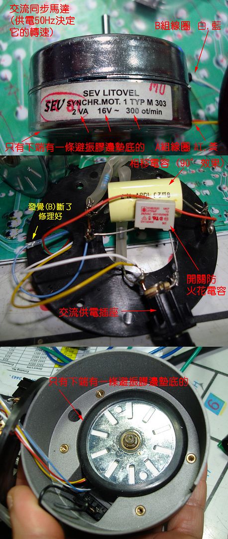

Krell的網友帶來Project TT 的 Motor,話佢轉得唔順,轉轉下會失速,希望check下是小事可以快修或certified可以去填海。他說那TT是Project cheap的型號 (我忘記了)

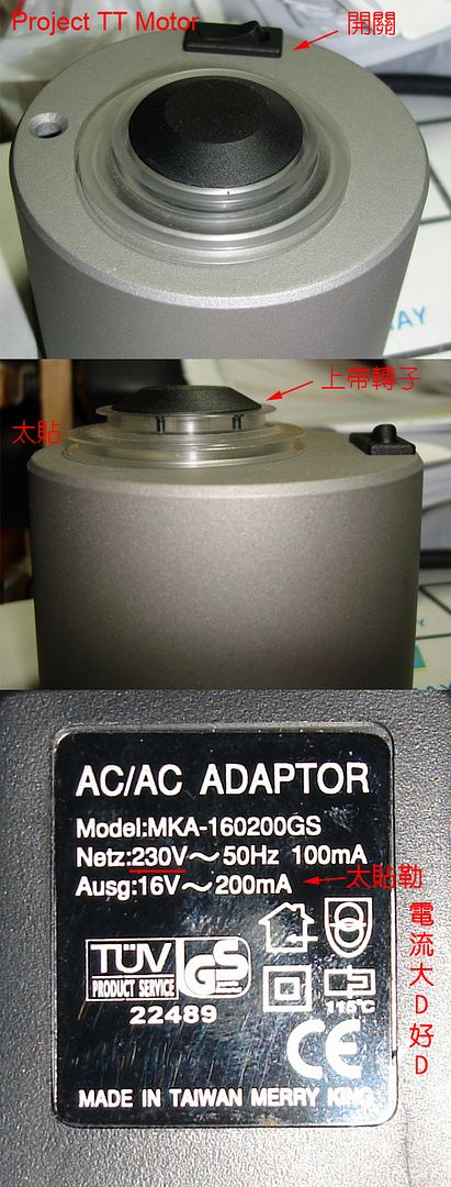

摩打的外形有點單薄及很輕的。用一個很小的230VAC->16VAC火牛供電(230V輸入的!)。
測試:
開電可正常轉動,但好像很無力,用手一觸它就停止轉動及原地振動。
打開它檢查看看(拆去底部的4枚螺絲)

摩打的內裏也頗簡陋,沒有什麼完善避振設計。
發覺一組線圈的接線斷了,從新焊接後摩打扭力回復正常(但它還是我所見TT摩打中最弱的)

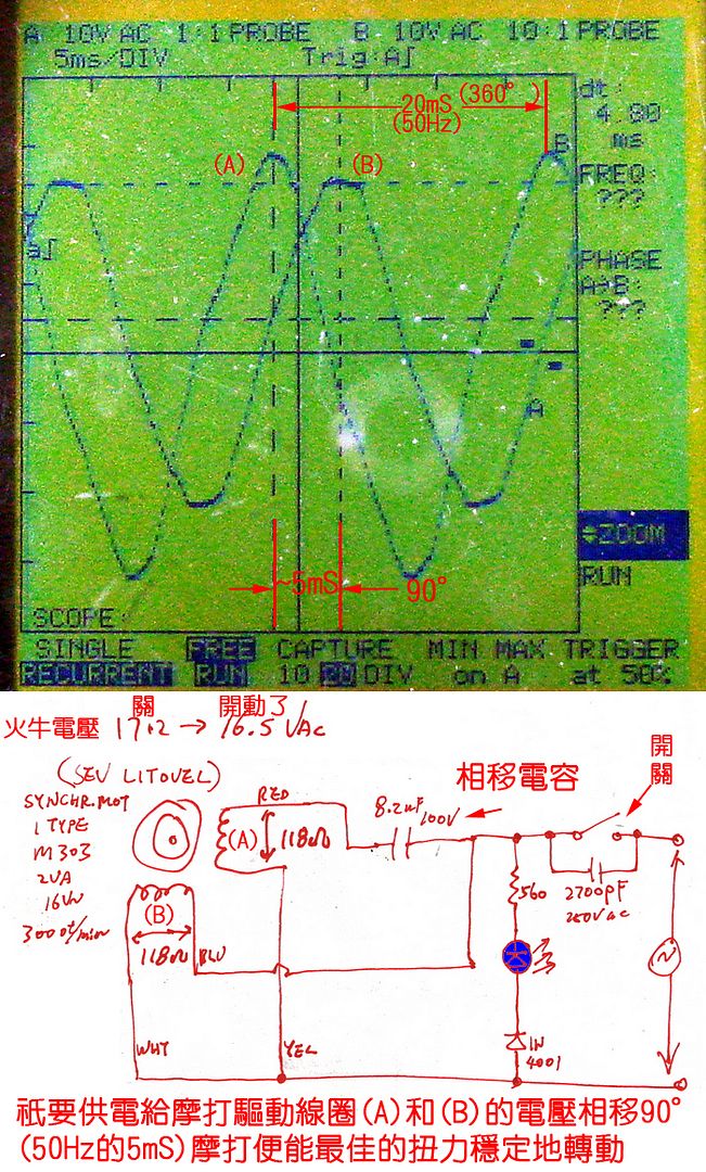

[#3] etsang3修理Project TT Motor
摩打為一隻,兩線圈,相移90°,交流同步摩打,輸入電壓頻率50Hz的時候,轉速為300/分鐘
轉速不受電壓波動影響,祇會受電壓頻率影響
附圖為測試波形,線路及工作原理

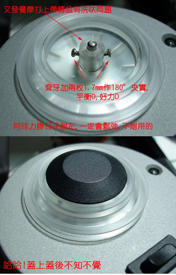

[#4] etsang3修理Project TT Motor
又發覺它的上帶小轉盆咬不實中軸,用1.7mm螺絲作小摩改解決。

[#11] etsang3修理Project TT Motor
曾sir,
a few questions:
1. where is the transformer?
2. what is the function of the 118ohm resistor?
3. and what is the function of the 560ohm resistor?
jnj
223.xxx.xxx.140
2010-12-27 19:59
[#12] etsang3修理Project TT Motor
hi,
a few questions:
>> The black AC/AC adaptor above.
>> Sorry, may be I am misleading you. those are the resistance of the motor winding (A) and (B).
That is for limiting the current to lid the "POWER ON" blue LED (16Vac after rectifier feeds to LED (~3V) is too high.)
etsang3
119.xxx.xxx.111
2010-12-28 10:50
